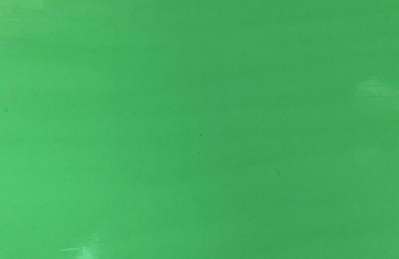

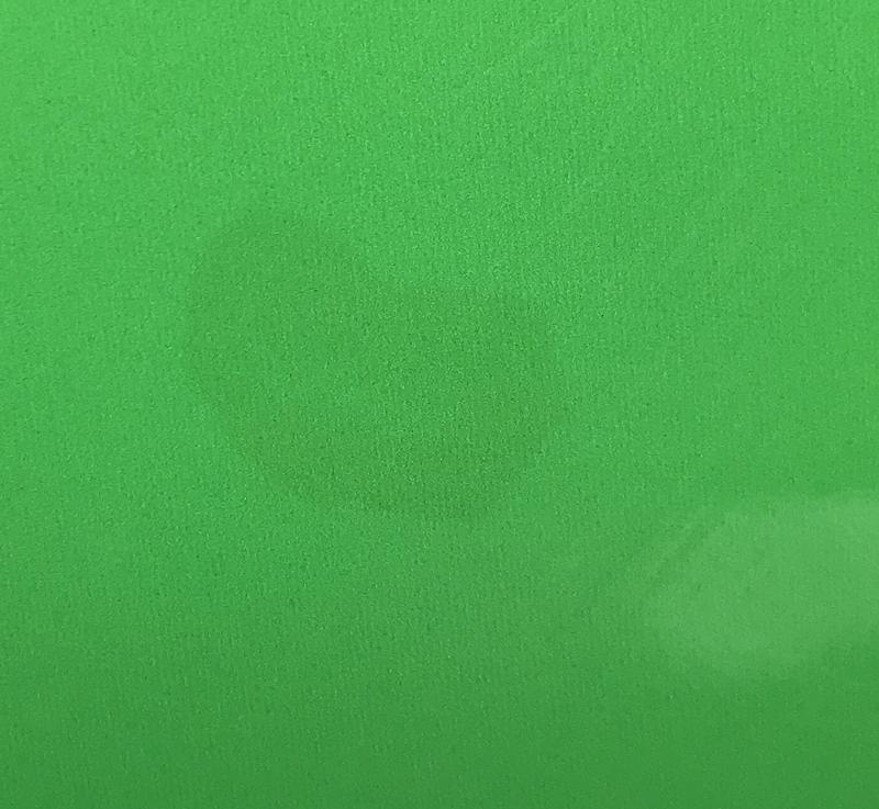

split,
we are having problems when installing we are getting white stretch marks with it stretching less than 5% we're getting brown spots in the material we are running three HP 370s and one 570 and it doesn't matter what machine we run it through we're getting the same results I sent 3M a bunch of pictures they're working on it right now IMG_5676.jpg IMG_5673.jpg IMG_5675.jpg

SC
its definitely not a profile issue !!!!!!! 3M is aware of the material getting random spots It is definitely a material flaw whether it was a bad batch or something
heyskull
Typical supplier telling me "their was only issues if the correct profile was not used".
Probably a bad batch.
Boy you are gonna have fun getting them to reimburse you as I have had issues with this before.
