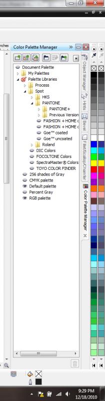

Alright, so this is odd, my corel seems to be displaying colors in the program as rgb colors, but it exports and prints properly, I've checked the display settings on how it handles the colors when involving my monitor and they are correct and I've tried resetting the software and even re-installing but it's still displaying as rgb. (I haven't tried the f8 while loading trick so i'm going to try that one when I get home to my studio ...)
I'm not really too concerned with this as it doesn't effect the end result and I use a custom color swatch preset or I open my big book of cmyk swatches I printed on my printer just to know my printer profile when designing ... it's just slightly annoying.
But if anyone knows a fix for this, it would be greatly appreciated.

in corel draw there isn't a way to set up the document to be exclusively rgb or cmyk, and you can in fact have pantones, cmyk and rgb all in the same document.
I don't thing its the color management since i've tried all the settings, and anything in there changes the output of the documents but it still displays cmyk colors as bright rgb colors. That and the cmyk colors were displaying as the correct colors before, and nothing appears to have changed.

Ah donkey farts. I found it ... it's the stupidest thing that prevented the colors as displaying correctly. (actually found it by accident clicking everything in rage ... great visual too of me cursing at the program and madly clicking hoping the mouse dies too) Attached is an image of an arrow that needs to be selected (either from the printer profile, seperations profile or the internal rgb profile.) ... if it's not selected it appears to not process cmyk colors, so any of the three arrows need to be selected, otherwise this is a pill of a problem.
