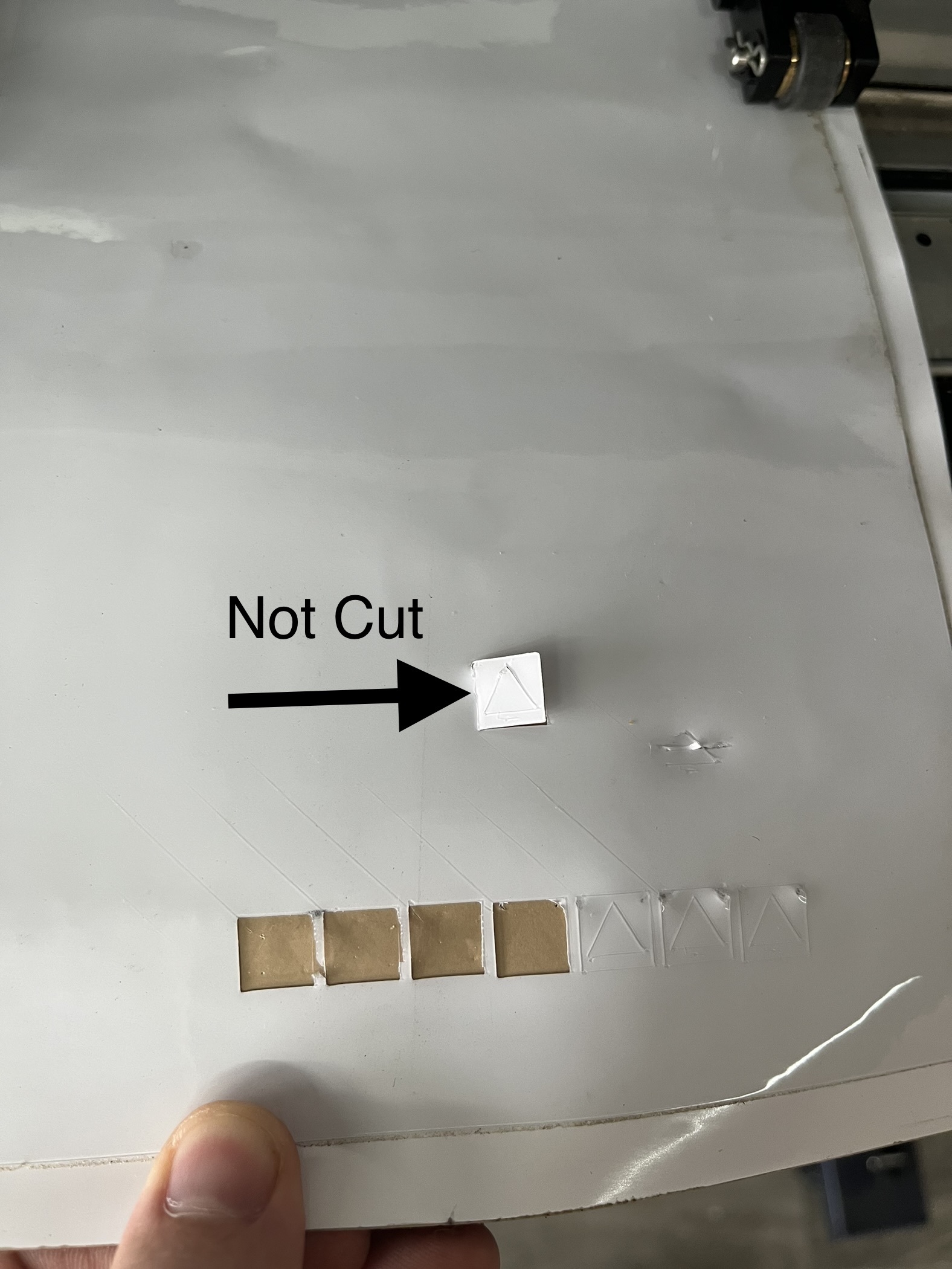

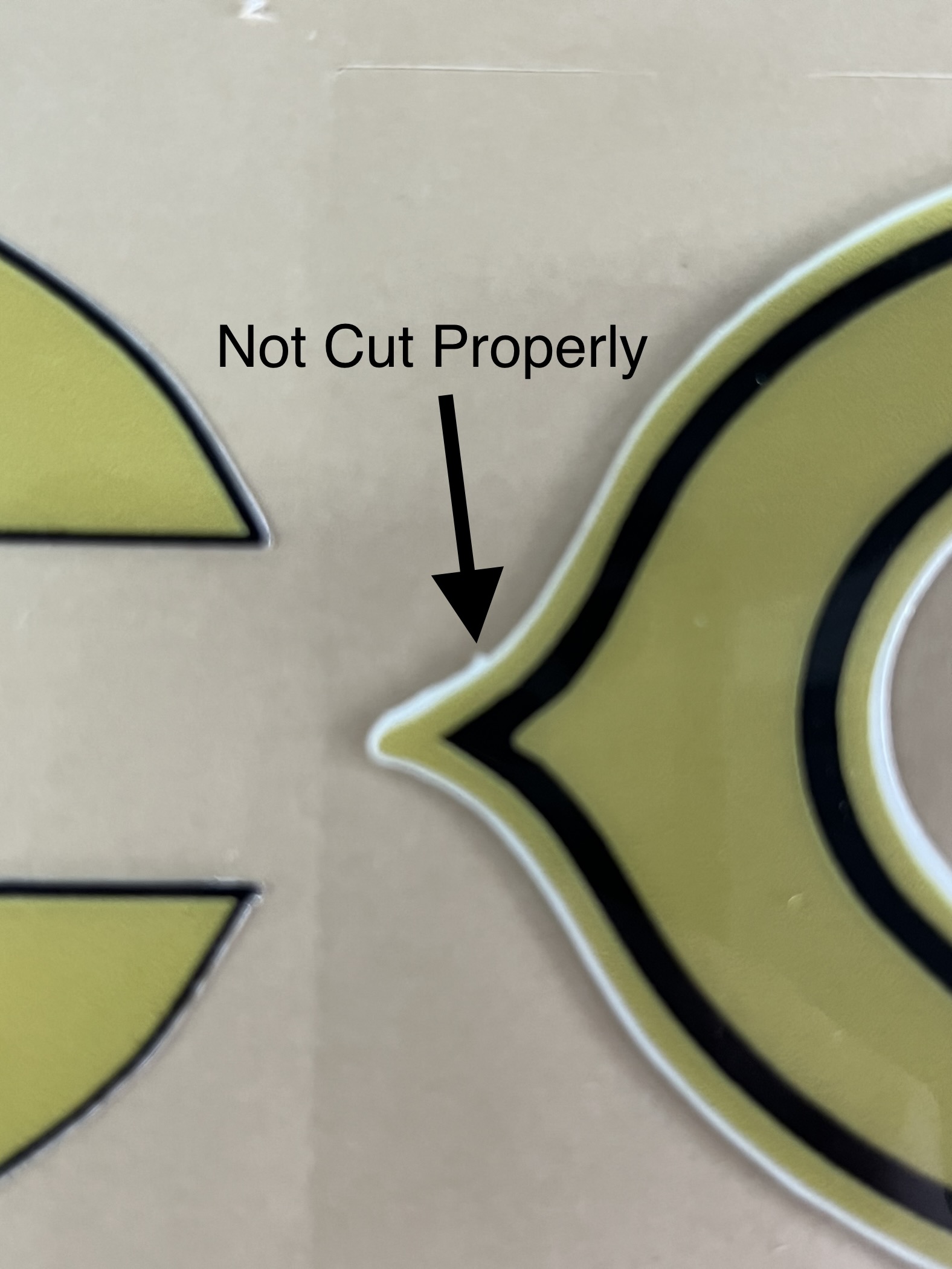

I am having an issue with my Graphtec FC-9000-140. It is cutting them deep enough in some spots. However, some areas are not deep enough when cutting out on the same job. The blade force is set at max and the depth is very deep and cut all the way through the vinyl a few times. The top knob has been twisted a lot clockwise to make the depth deeper. The vinyl I am cutting with is Substance Incorporated's ULTRACURVE H1 and ULTRACURVE 1500S Overlaminate. This material is made for Football Helmets, Construction Hard Hat Stickers, Baseball Batting Helmets, Dirt Bike Helmets, etc. The blade I have on the plotter is a 60 degree blade made for deeper thicker materials like Reflective Vinyls and Substance Inc ULTRACURVE H1 with ULTRACURVE 1500S Overlaminate. What is the issue with the plotter not cutting deep enough in some areas and deep enough in other areas?

6 mil vinyl + 15 mil laminate. I would try doing several cutting passes. I know I would not enjoy trying to cut detailed stuff on 21mil material on a roll2roll cutter
trafficbarriersolutions
TRAFFIC & BARRIER SOLUTIONS, LLC
Back off on the pressure, blade just deep enough to get through the vinyl/laminate. Run that 2-3 times, same pressure, same blade depth every time and see how it goes
The only thing is is it cut too deep and went through the vinyl completely but not in all areas. Would it take the vinyl with it if it got stuck on cut through surface and tear up the plotting?
JBurton
Signtologist
So, thickness aside, this problem is usually from an old teflon strip. The strip right below the blade is replaceable, $20, and worth a shot.
The blade won't necessarily take anything with it if it goes all the way through vinyl and backing, sometimes you don't even notice until it's getting weeded.

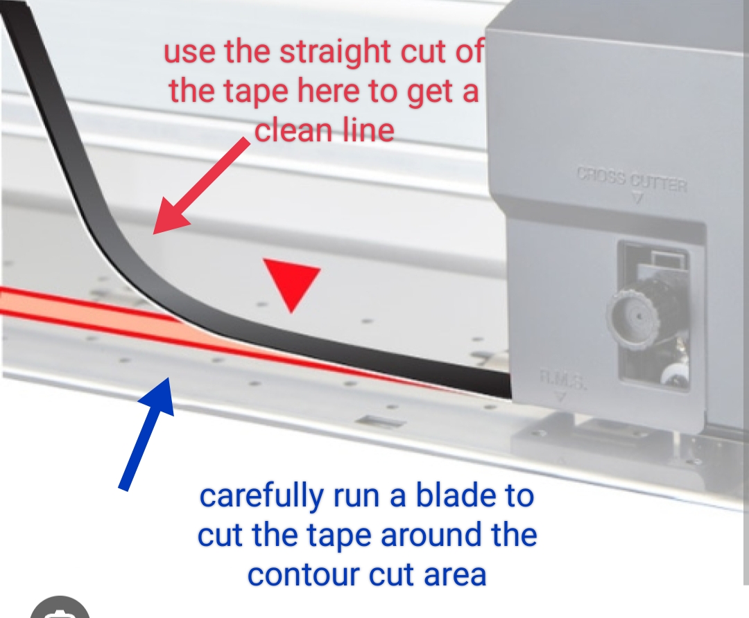

Try using Gorilla black duct tape as your cutting strip. Remove the old cutting strip, eliminate all excess glue, and thoroughly clean the surface with 91% isopropyl alcohol. Use the straight edge of the tape as your guide (see the attached image) and carefully trim the excess tape around the contour cut area.
I learned this trick the hard way when I got stuck with a large order on a weekend and had no extra cutting strip on hand. Since then, I haven't encountered any issues with uneven cuts, ghost cutting lines, or weeding issues.
Another recommendation is to learn how to set your blade pressure properly and create a profile for each material you cut (Vinyl, PPF, Vinyl + laminate, etc.).
This should resolve most of the headaches you are currently experiencing.
