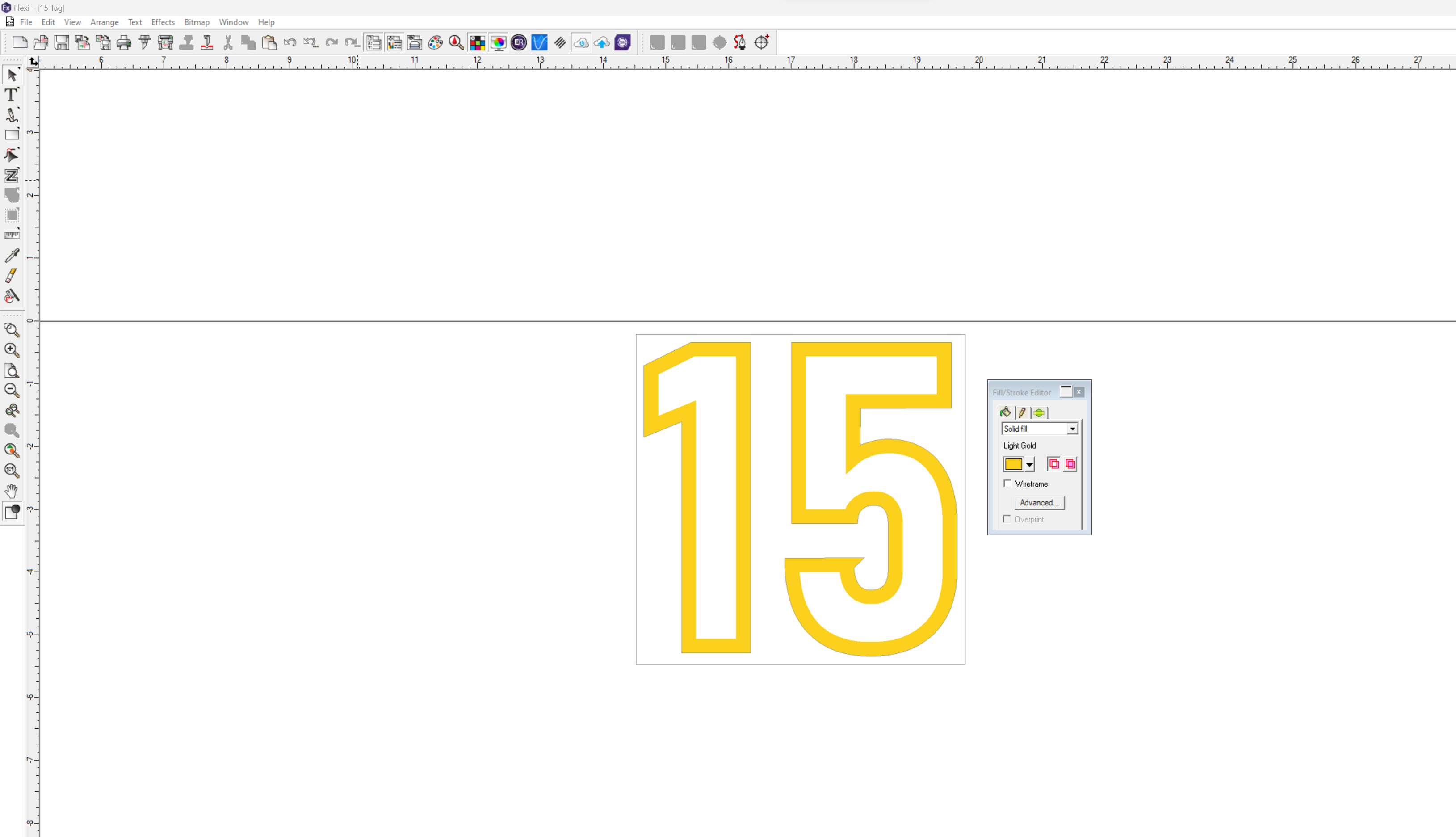

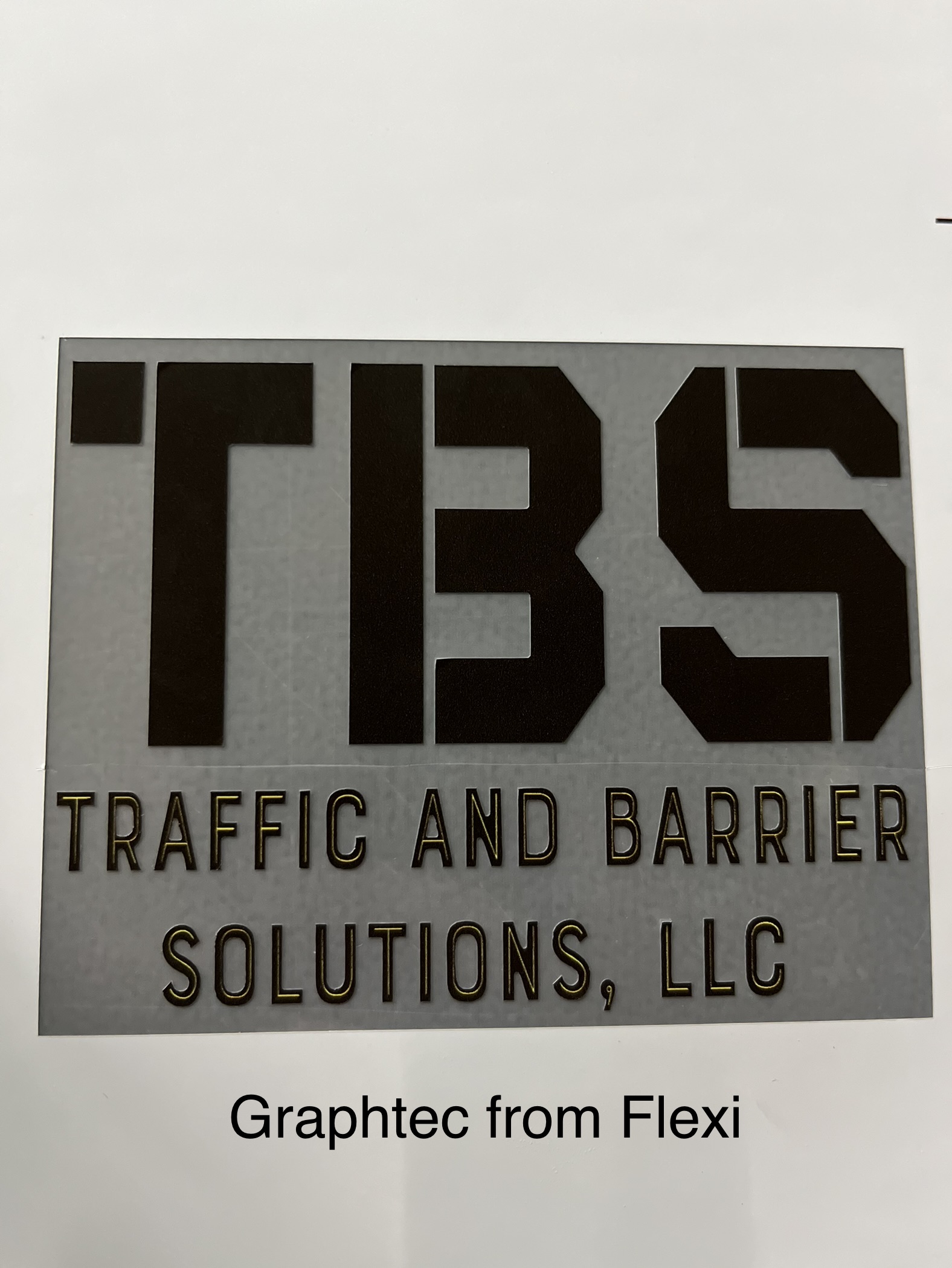

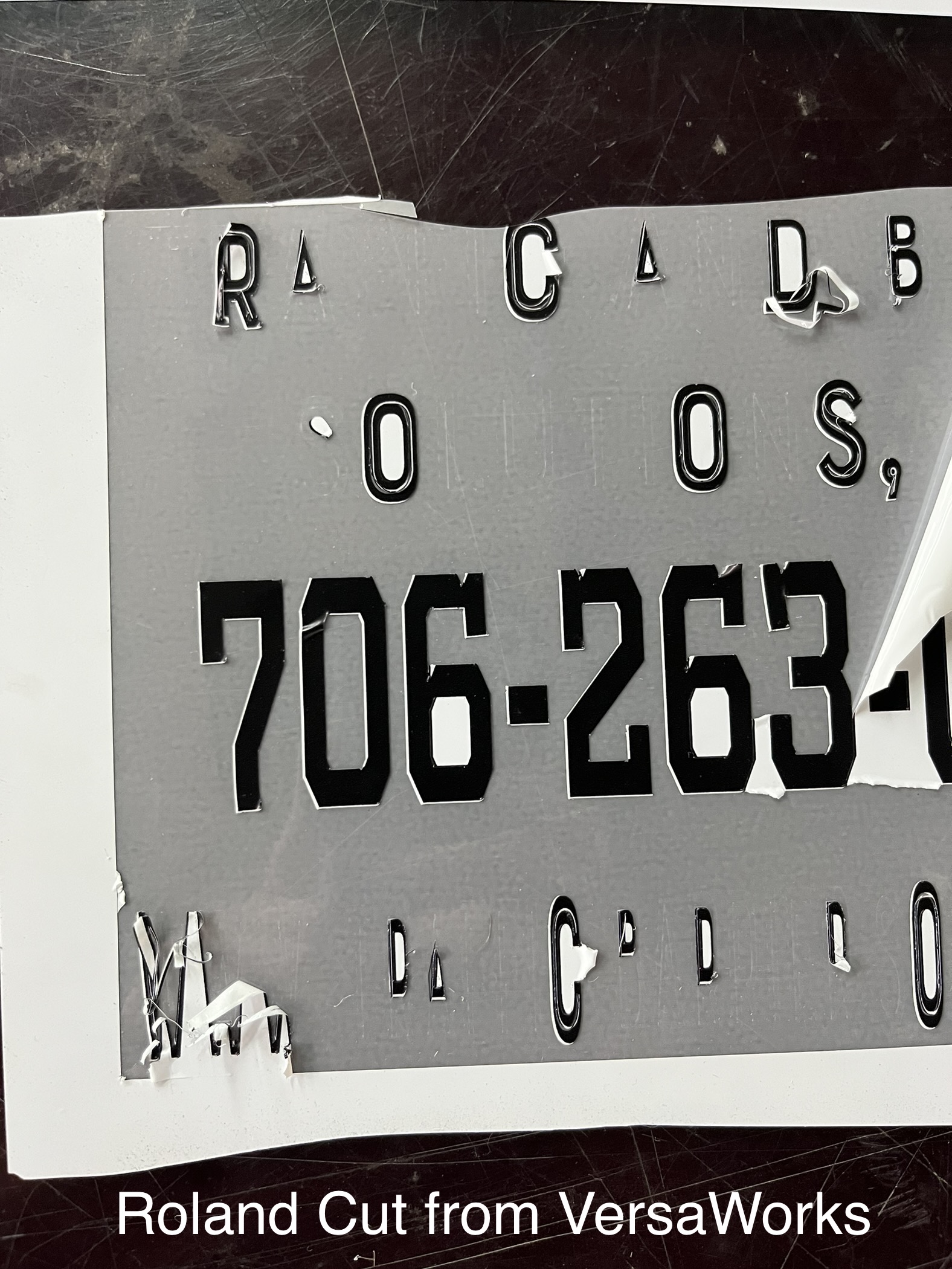

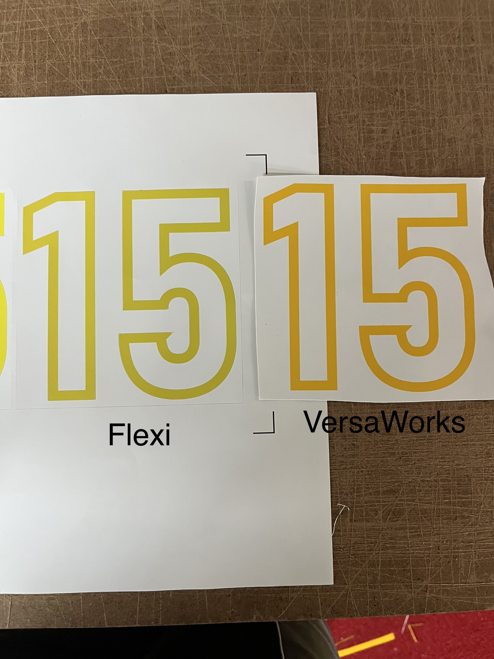

Hi,
I am having trouble with my Roland printer when it comes to printing. It seems as though Flexi's Rip and Print software makes the Roland printer print incorrect colors. However, if I use my Graphtec to do my contour cutting, it is 100% correct. The opposite happens when I send it to VersaWorks, the colors are 100% correct, however, the cutting/plotting is incorrect on the Roland. Not only do I want my colors to be correct, but I also want my cutting/plotting to be correct. VersaWorks prints the colors correctly and my Graphtec plotter cuts correctly. Is there a way to connect my Graphtec to VersaWorks to send contour cuts. If VersaWorks is not compatible with Graphtec, is there a software that can not only help my Roland print correct colors, but also use my Graphtec for plotting?

With regard to the colors printing differently in Flexi and VersaWorks, sounds like a color profile problem.

I figured it out. I used the Contour Cut Marks to put marks on it and send it to VersaWorks. That way, it will keep the correct coloring when printed from VersaWorks. Then take the Vinyl and put it on the Graphtec. Press
(Contour Cut) button on Flexi. Adjust the settings to the correct alignment, blade force, and speed(depending on the vinyl used). Click "Send" and then it will read the marks and cut just right.
