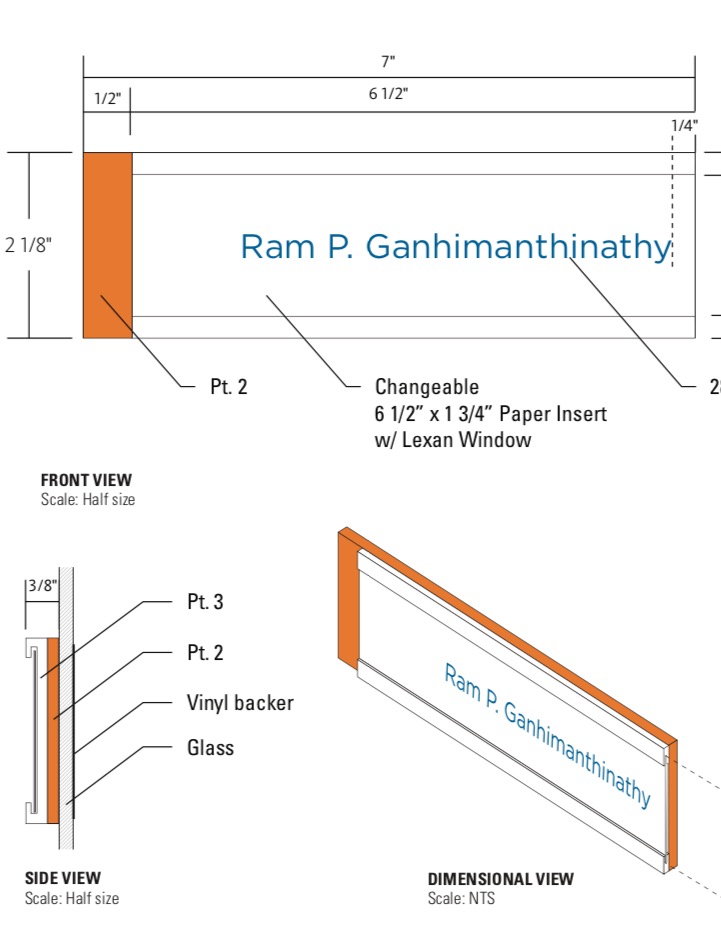

I'm going to start producing some interior signage to try and utilize the workshop I've been growing.
Can someone help me find a vendor for the white channel in this photo?
I looked for an hour but couldn't find the specs of 2-1/8"
Thank you!!

Are these door signs? or cubicle signs?
If it's a door sign, this is not ADA compliant, or they are trying to find a sneaky way too bypass ADA...
When I see a call out like this, it's the designers responsibility to note the manufacturer of that C channel... I would go to the designer to find out where they got that
2 1/8" call-out...
If they made it up, the designer should modify the design to fit a stock channel, or design a way for a sign shop to manufacture it... (2 pieces of acrylic - paint header/footer, VHB to make a void for the sliding message)
I just googled "Nameplate Sign" and "Cubicle Sign"... there are a ton of options for 2"...
Rick
oops, it looks like the 2" might actually be 2 1/8" overall height...

Rick thanks for the reply. You and I are on the same page. The designer or architect agency has been utterly no help.
I've had these done outsourcing about 10 different projects already over the years, but the main vendor I used royally screwed a job up so I had to stop using them. So I've used a couple vendors since and they got it no problem.
However the most recent vendor I considered using had a tough time like you and I finding the 2-1/8 size.
I feel a little awkward asking vendor where they got it since I'm leaving them to do it myself.
Anyway I'll keep searching.

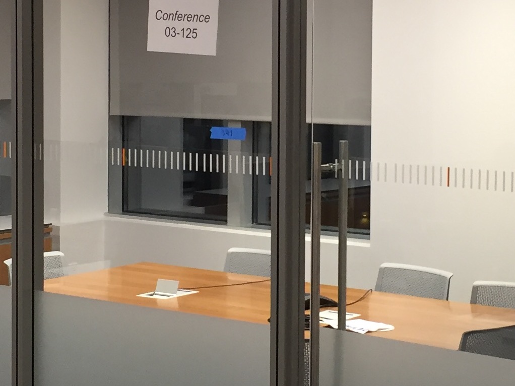

Before I go I wanted to show you this picture. This is the job so far. You see the hash mark? Those are also 2-1/8 and I cut them out and install. Then the name plate will fit right with it so everything is the same height. Does that make sense?
So it's not really and option to tell architect to switch to 2"
Maybe in the future I can just make it 2" even the hash marks and no one would probably notice. However that is not how I like to do business.
Rick wherenis this one from? I might just go with 2" and center justify which will leave 1/16 top and bottom. Should be fine right? Ha ha
Rick
I don't know if you noticed my last post but I believe the C-Channel I posted is 2 1/8" overall height.
It's a 2" channel inside, but if you add the upper and lower walls, it's 2.125" - 2.13" - see the link below
Plastic C Channel
jkdbjj
Plastic C Channel
Ah hah, I didn't catch that.
I will give them a call. A big page opened up and said their phones are down or something like that, but this might be perfect.
