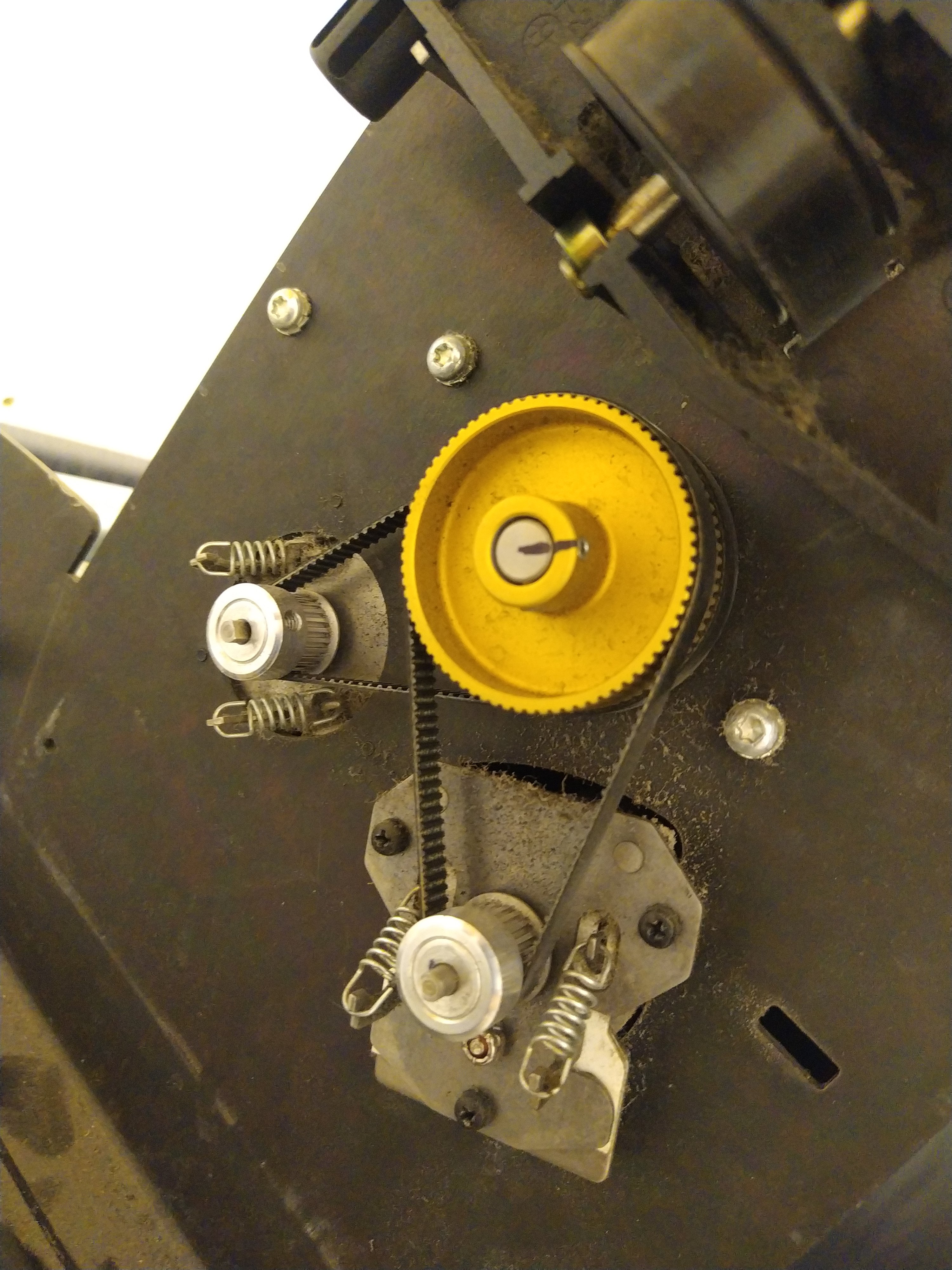

unmateria
Hi! Never had any problem with rollers. In my case is always the same, the 2 little prisoner screws inside the drive belt pulleys (in the left tap). Just tighten them every 6 months and you can cut thousands of circles at one time

Can you take a quick photo or even make a simple diagram showing their location?
unmateria
Hi! Just tighten the 3 pulleys with an allen key

You should replace the belts too. The small belts on the motor, and the large belt driving the cutting head (a little bit expensive).

I'll check the screws and then do the small belt. I've got belt material with the right tooth profile so I think I can make one up.
