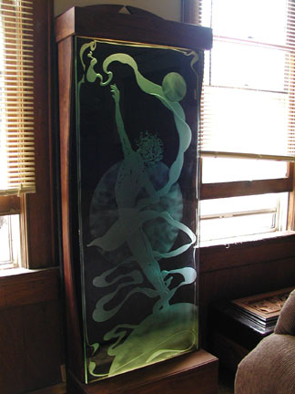

Here is one I have in my house.. This was stage blasted with heavy mask at around 120psi..
Just intermediate vinyl will work good for frosting but you will want to turn your pressure down to about 30psi or less when using Black beauty or you can blast right through the vinyl.. If your using quartz I would start about 20psi as quartz is sharper and can easily cut the vinyl.
Have forgot to do that a few times and ruined the glass.
