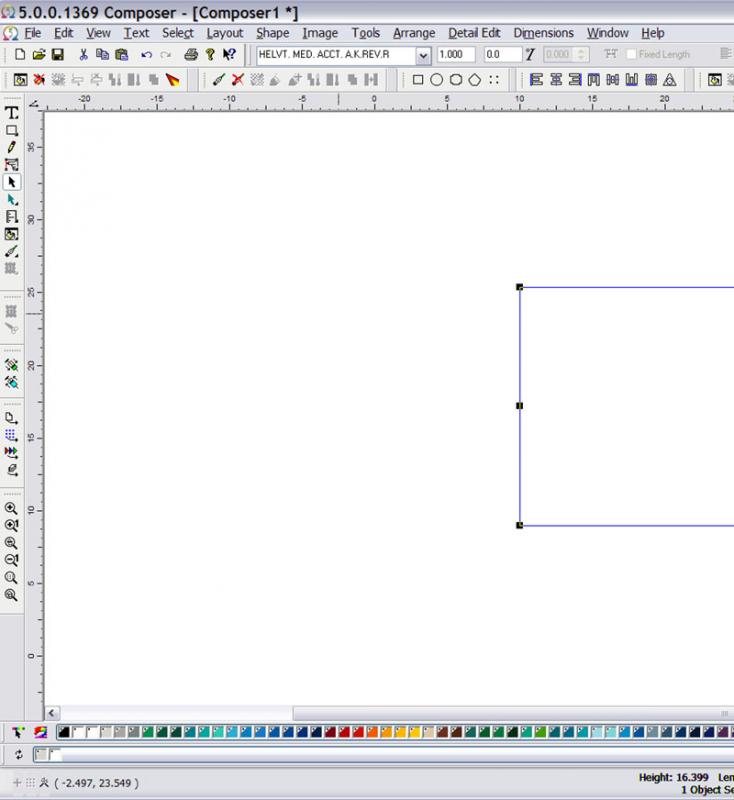

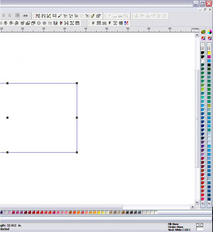

The Print/Output Order Dialog may be accessed in Composer by entering Control +D. You can also add it to your tool bar, which I recommend. See attached images below.
If you are using the layers feature in Composer, I recommend that you stop doing so. It will serve more to confuse you than do you any good. I recommend that you do your layouts on the same layer as long as all the objects, regardless of print fills or strokes, are on the same vinyl.
In case you're interested, here's a split screen shot of how I set up the Composer workspace for myself:
