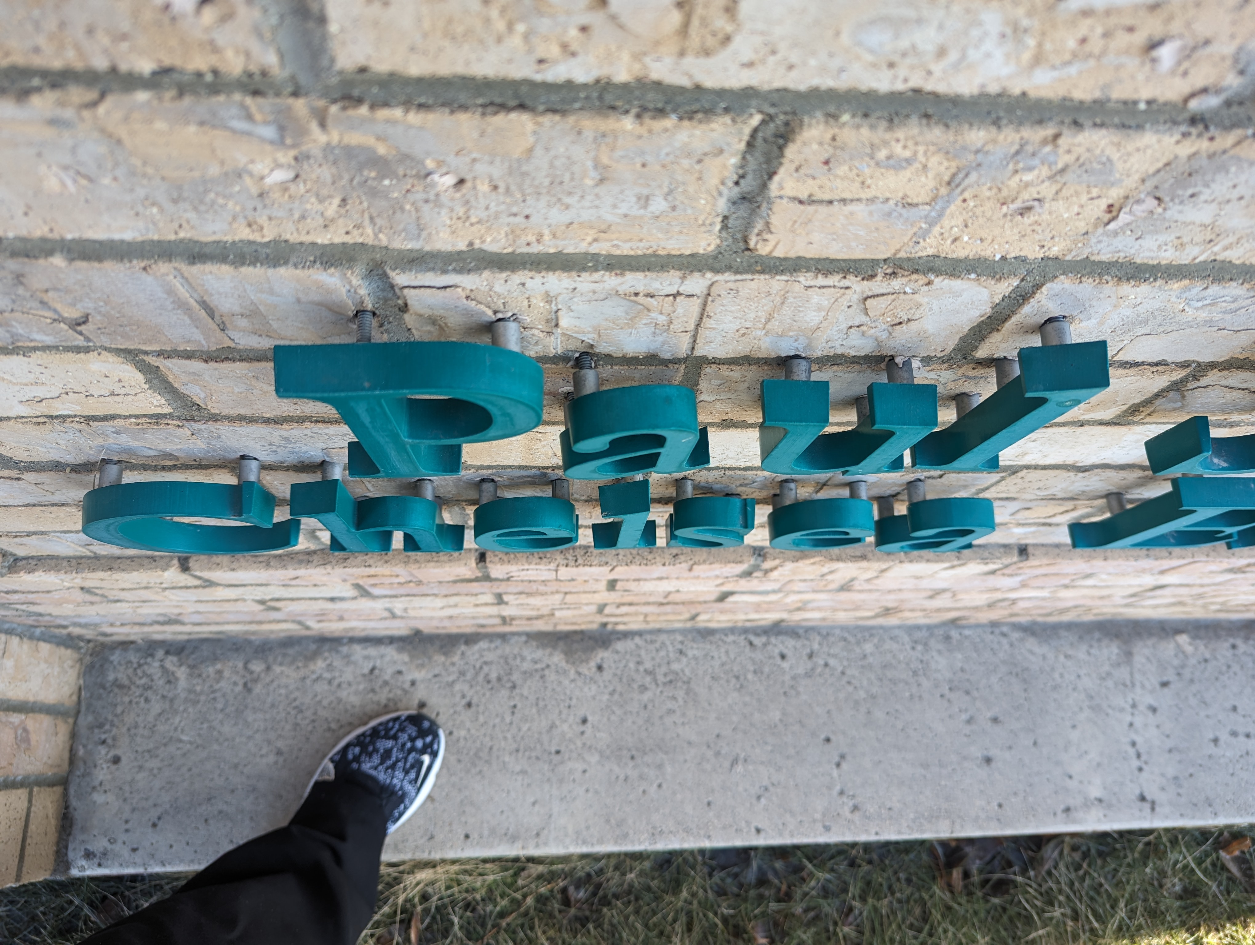

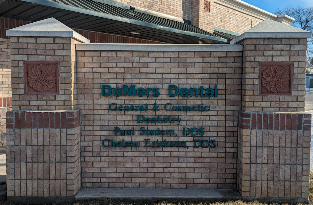

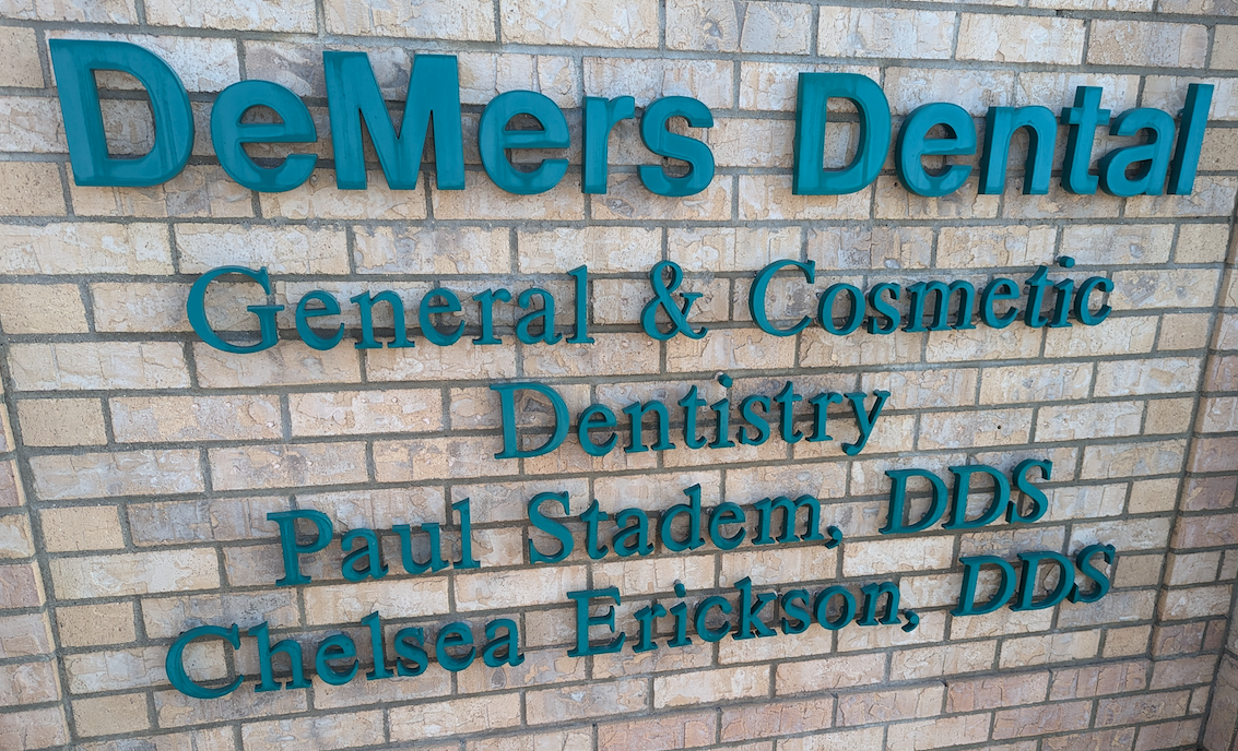

I have a client that has an existing monument sign with dimensional letters on face.
As a total rookie (flat work/print shop) I am intrigued with the job and wondering how you would approach.
There are 5 lines of text on the sign and one of the lines needs to be deleted and replaced (new name).
I am wondering if (by looking at the photos) anyone can tell what material this is? It is a two-hour drive to location so I do not really want to drive just to determine the material.
ALso curious if you would suggest changing all letters or just the line with new name? I understand that new/finished letters would look different than existing.

rossmosh
If I had to guess, it's either painted PVC or HDU. I'm leaning towards HDU. It could be painted acrylic, but I have my doubts because it's such a flat finish and typically if it's acrylic, it's provided by someone like Gemini who uses more of a gloss finish.
As for the job, if they're cheap, the easiest way to handle the job is to cut down just the name and replace it with new letters. Do a different color so that you won't have an issue with things not matching up.
Otherwise, I'd cut down all the letters and replace it with a panel with dimensional letters. If electricity is near by, you could backlight the panel to give it a bit more of a look.
bowtievega
With that thin of a stroke I would do either flat cut or cast aluminum, especially if they are on standoffs as they are in this application. Looks to me like those are a cast product, you can see the slight bevel on the edge and they are probably around 3/4" thick with isn't real cost effective for flat cut. We would order those from Gemini. I would definitely match the existing paint to a color chart and ask Gemini to match the color and sheen of the paint finish.
JBurton
Signtologist
I'll wager on cast aluminum, notice how the rear sides of the letters appear to be wider than the front, as the edge approaches the back you can just barely perceive this slight taper. As far as the flat finish, I believe they are just old enough that the paint has given up the ghost.

What's happening with those studs and spacers? Looks like a bit of a hodge-podge install to me.
Personally I'd sell them a new set of cast aluminum letters from Gemini.
I guess one downside of doing all new is that you'll be left with a bunch of holes everywhere from those studs.
The contrast between those letters and the brick/mortar isn't too great either, could maybe suggest some kind of lighter color backer panel while you're at it, depending on their budget.
Judging by the amount of oxidation and fading, I'd say they were in a long time and fatigue has set in in both the holes and lags. I'd have a good conversation with the customer explaining what all needs to be furnished to make it look good.

I agree with them probably being cast aluminum. Looks like they are incredibly old or were painted by the sign company, not someone like Gemini.
I'd price a the replacement letters from Gemini, buy them with as close a finish as you can to the final color. Remove them all and paint them all, including the new ones
and reinstall. The line of text that is changing should have the holes filled with a color silicone close to the brick color.

I also believe these letters are cast aluminum. The bevel is the giveaway. The bevel is required for release from the sand mold.
