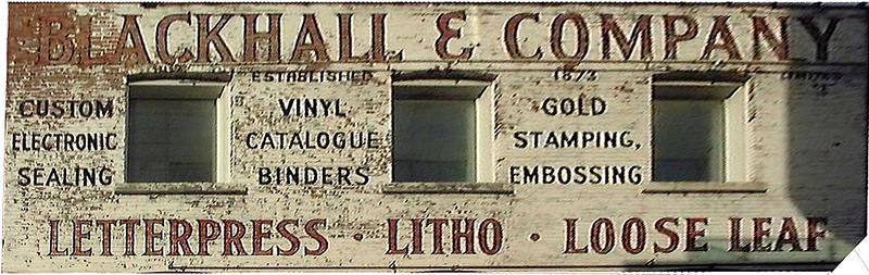

Here is a photo of a sign I am supposed to restore but now the whole sign is gone. Any body know what fonts are here look like 2 types.
I would end up recreating it on illustrator then create paint mask stencils.
EDIT,,, seems like Im being misunderstood this isnt a distress call. Im simple asking if anybody knows the font. If I recall this is the font area?
Im not asking for more pictures I have plenty of pictures.

Fonts? First you mean 'type faces' and second, that sign was done by hand in whatever style moved the sign writer that did it that day. One thing is pretty much for certain; he did not say to himself or others "I think I'll use this or that type face on this sign."
If you want to reproduce that work digitally then you'll have to start with something that maybe might could sort of resemble that copy and modify it until it actually does. Have fun.

Sooooo.... you are not "Restoring" it, you need to "Replicate" it!
Cutting to the chase here... you won't match it using fonts. Each "Wall Dog" had their own letter styles based on what they had learned and whom they had learned from.

Seems like your request was misunderstood. I've seen the work you do on your website and it's impressive. Obviously this is right up your alley but I don't think you'll find fonts on a computer that will match those. As previously mentioned whoever did that wall originally just used their style of "type faces".
I'd say just bring in one of the pictures and find something similar and start tweaking.

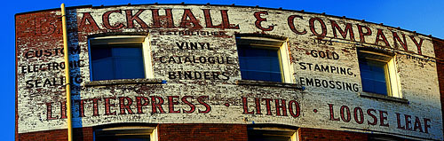

So in consideration of everyone advice. I just ended up warping the picture in photoshop so that it was flat and then drew the letters out 1 - 1 in illustrator. I included all the nuisance of the letters to didn't correct them. Its coming out pretty well.I'm cutting the vinyl stencil now. Id say it will be within 95 % of the original if not more accurate
This is an example of the distorted image I drew from. After this image , I took each word and made it perfectly straight, I know this one is still a little off.
