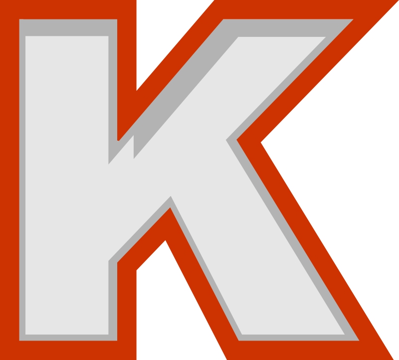

I use flexi and can't figure out how to create these inside shadows, I have Photoshop and illustrator but I'm not too fluent with those. Any help is appreciated 1427847029611-1371301698.jpg
bob
In the image you show those shadows appear to be merely multiple objects. You can see the bit of sloppiness on the two inside corners shown. There's any number of ways to create them. Multiple inlines on the white fill, drop shadows on the red outline, etc.

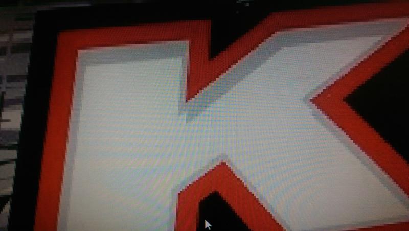

Tried for a few hours yesterday to no avail, this has to be a applied effect just can't find the way

You could offset the letter, move it in the lower layer and change the color of the "shadow"... The one that's in your picture appears to have 2 light sources so you would have to do that by hand if it's indeed what you want and not a mistake on whoever created that art.
bob
Here, 5 minutes with Corel. Just a letter with a couple of contours and some judicious trimming.

Not too complicated to do in Illustrator.
Directions for Mac
Type lettering
Convert to Outlines: Command/Shift/O (letter O)
Offset Path to outside. Whatever size necessary.
Use Direct Select Tool(white arrow) to select all the inner paths.
Make a Copy of the selected paths. Option/Click/Drag (these will become your shadow line)
Go back to your original lettering and select everything.
Pathfinder Tool: Click on Minus Front Option. This will leave the outside of the letter.
Now go to the copy of the paths you made and use a negative value and Offset Path again
Select all and use Pathfinder Minus Front Option. This will give you an outline shadow.
Make as many copies/colors of this as you wish.
Be sure to place them behind your main color.
