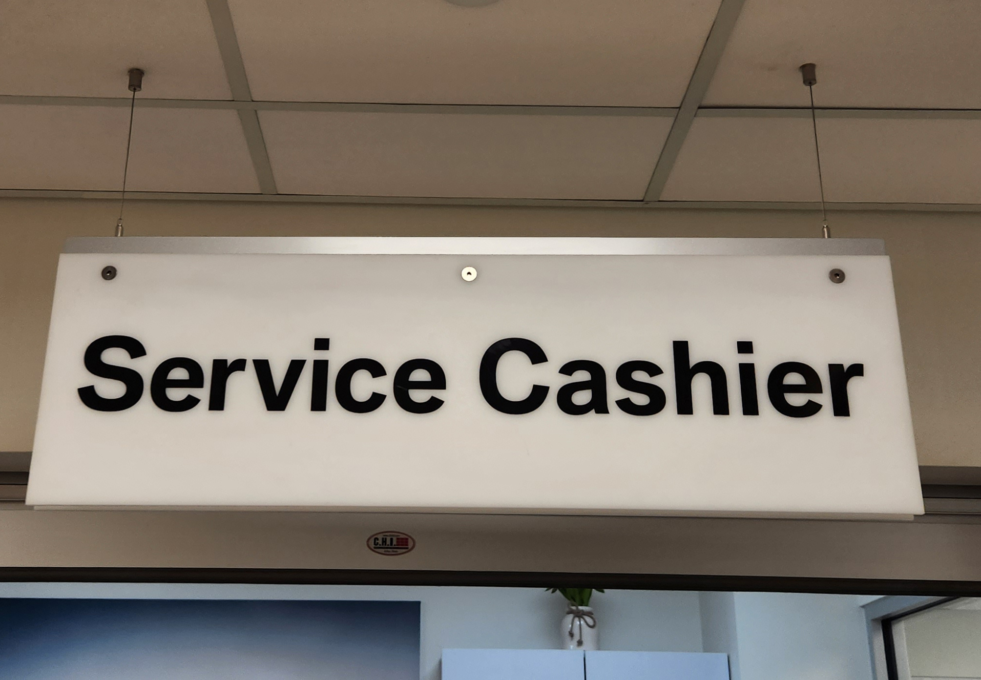

Has anyone seen similar hardware to this? Customer wants to add some additional signage that matches. Trying to avoid having to completely fabricate if possible. Something pretty close may fly
