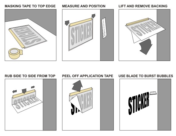

decal application. Drawn in corel draw for your customer reference. Print off and send with decals.
lift and remove backing should actually show the other way. Peel the backer off from the hinged edge not the other end. And for larger decals don't remove the backer entirely, use it to keep the decal from flopping around as you squegee down.
