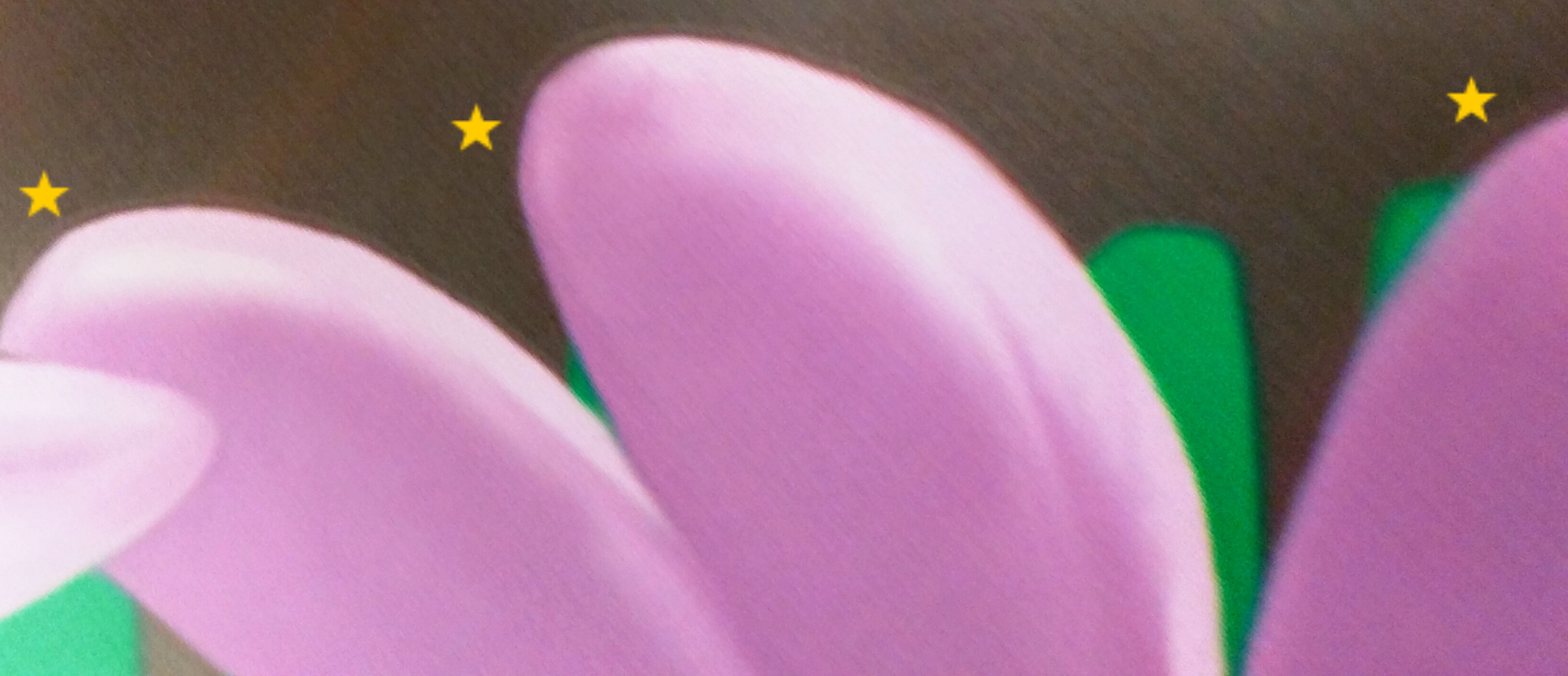

Ghosting
J
Ghosting
Yellow stars have been added to the photo to illustrate the issue
Looks like encoder issues. It looks like the scan direct on your print is diagonal?
Did you put in a new OEM Roland encoder strip and sensor or a china version? You redid the limit, encoder set up and calibration after installing them?
