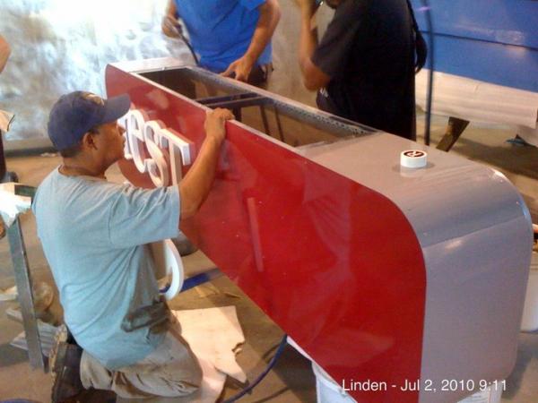

Restonic, .050 aluminum shell. Faces cut and holes drilled on router. 1" thick Komocel letters with corresponding hole drilled in the back. Letters at
