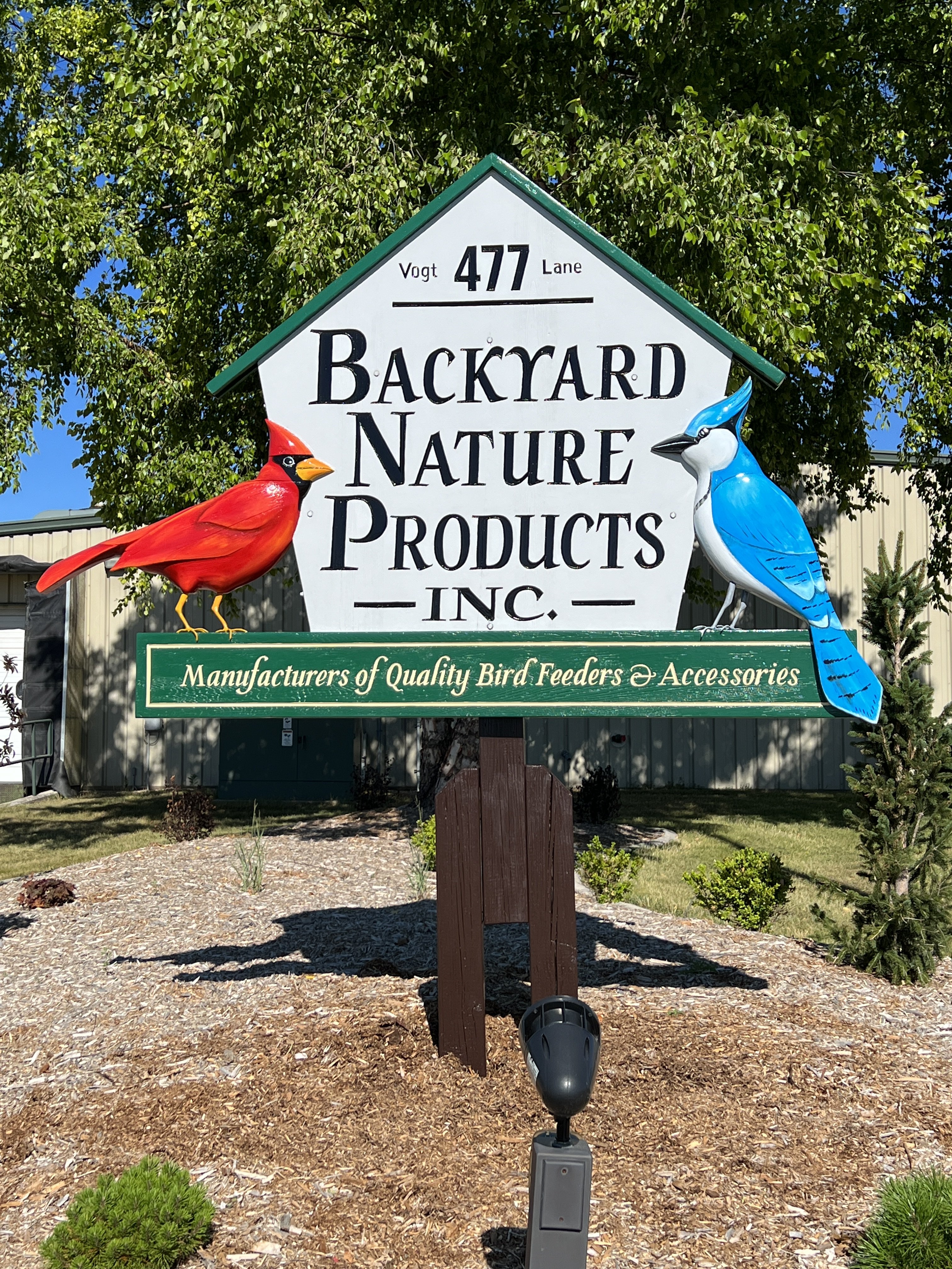

I painted a large outdoor sign 2 years ago. I primed and painted 2 coats with 1 Shot paint.
The red has faded completely away. How do I clean it to repaint?

The only red I see on this sign is the bird, and it doesn't appear faded.
All colors will change through UV exposure, oxidation, and wear. Red is the worst (red paint reflects red, which is relatively low energy, and absorbs the higher energy blue colors from the opposite side of the spectrum).
Some paints are more susceptible to this than others. Red Oxide and Burnt Umber are remarkably colorfast (Red Oxide is Barn Red). Mixing blue (black) or green into your red will tone it down and add to its longevity.
Adding a UV protection clear coat will also help (it tones down your color as well).
One Shot is specifically formulated for outdoor use and to resist fading. Back when there was cadmium and lead in the formulation, it resisted fading better (along with covering much better, something essential for brush lettering). I have signs up that are 20+ years old that I painted with red One Shot bulletin (modern formulation, no lead – that's been gone for years) that show considerable fading, but they still look fine and the red is still red. It may come down to what you can tolerate. In the picture you sent, the red bird looks fine to me. If there was red somewhere else it must have faded away completely!

This was the taken when i finished and had it placed at the business. I didn’t take a pic of the faded sign, though I can if you want to see it. I wiped it yesterday just with a cloth and there was a bit of oxidation, but still unacceptable. It looked so great when I finished it. I take pride in my work and I am so disappointed in the appearance after two years. 1 Shot really let me down!

This was taken when i finished and had it placed at the business. I didn’t take a pic of the faded sign, though I can if you want to see it.
When asking for advice, it is always best to include the project "in its present state". Although the original project is nice to see, the project in its deteriorated condition would get you the best responses.
