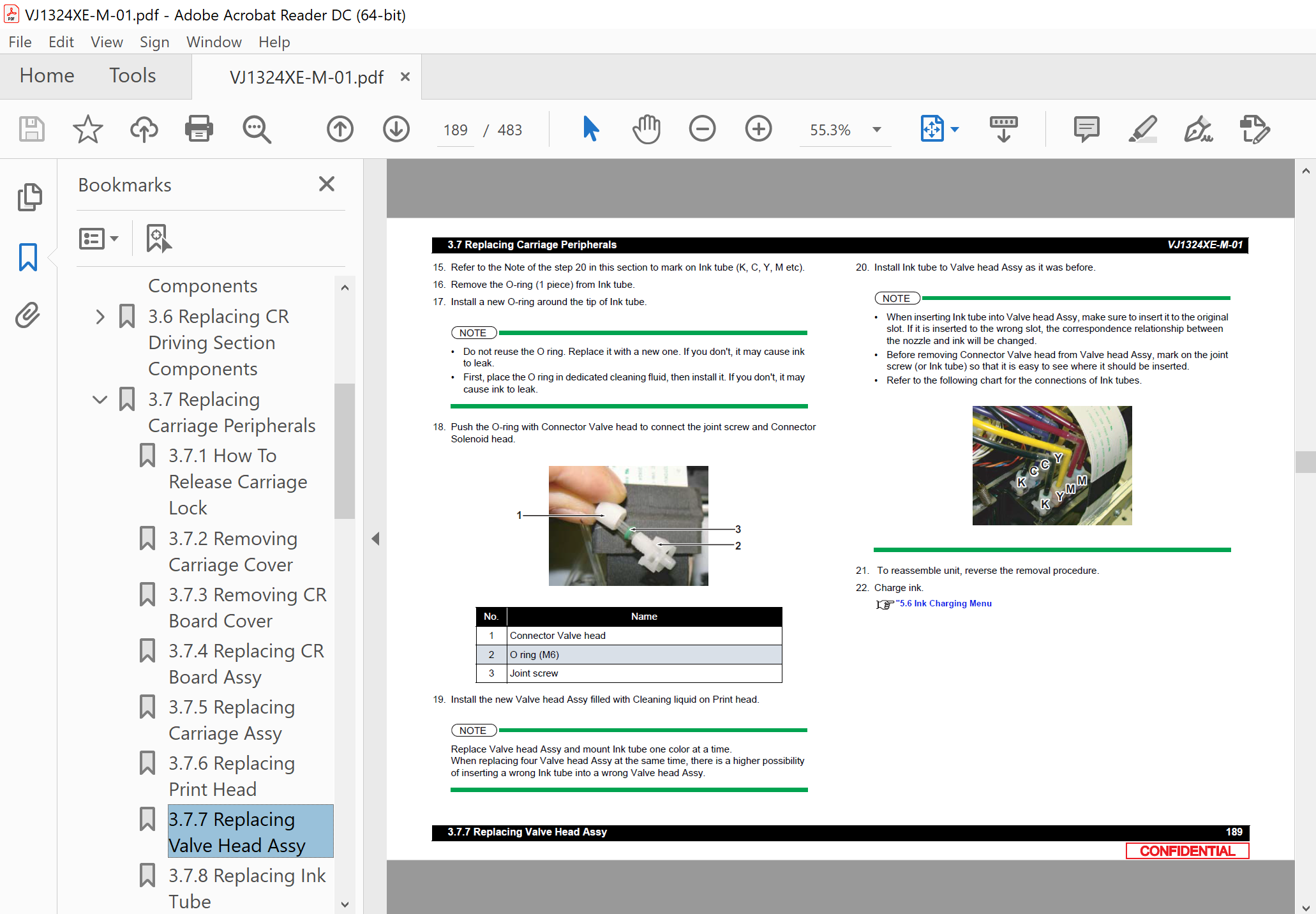

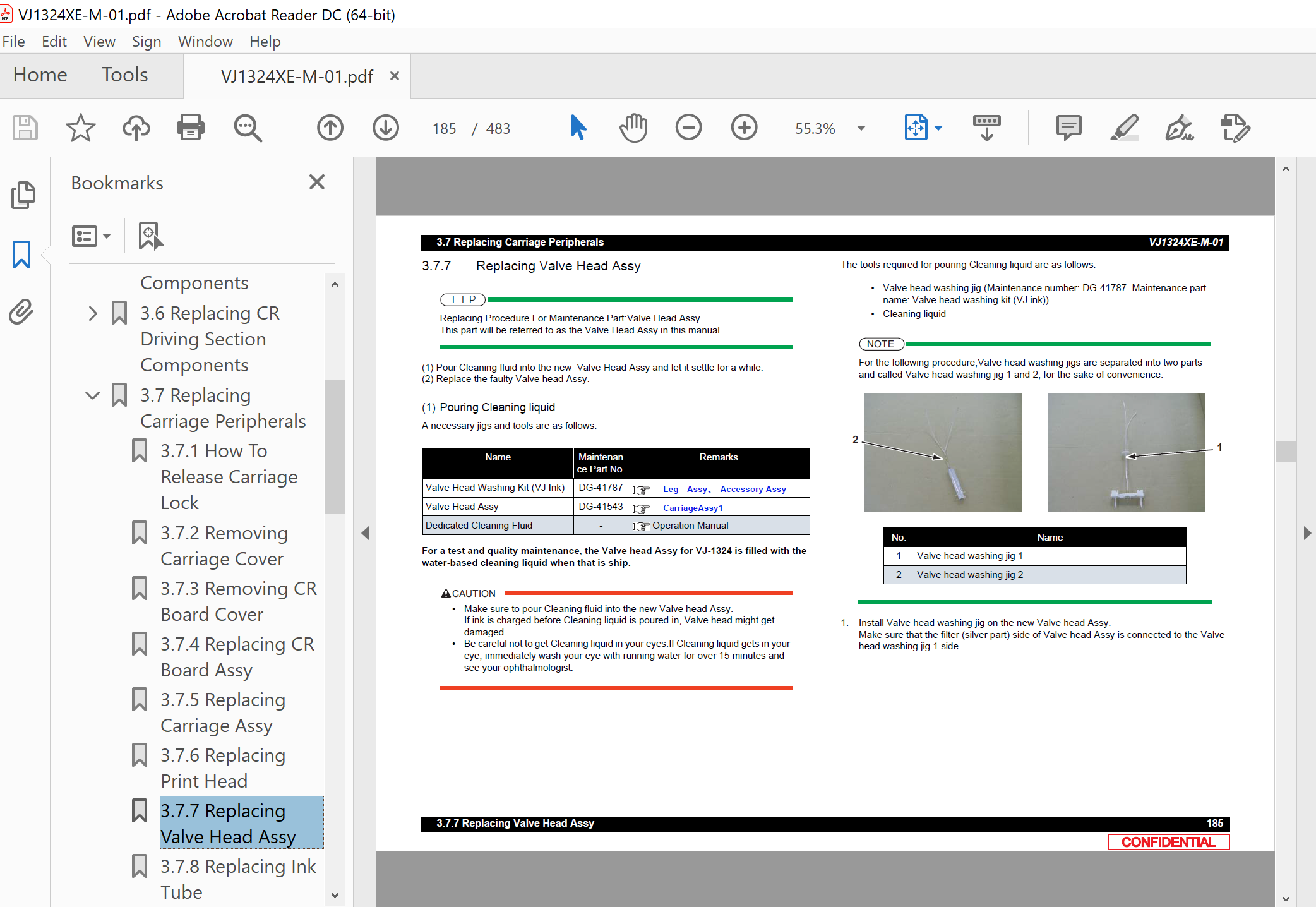

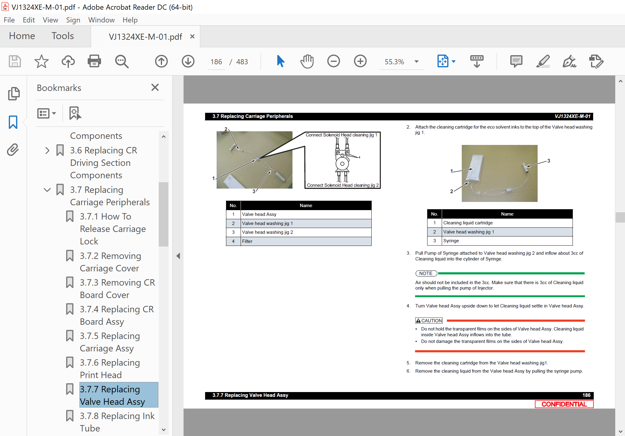

Please see attached screenshots, when using genuine Mutoh valve dampers, you need to flush them with cleaning solution before inking
ice_screenshot_20210928-100454.png ice_screenshot_20210928-100515.png ice_screenshot_20210928-100700.png ice_screenshot_20210928-100718.png
