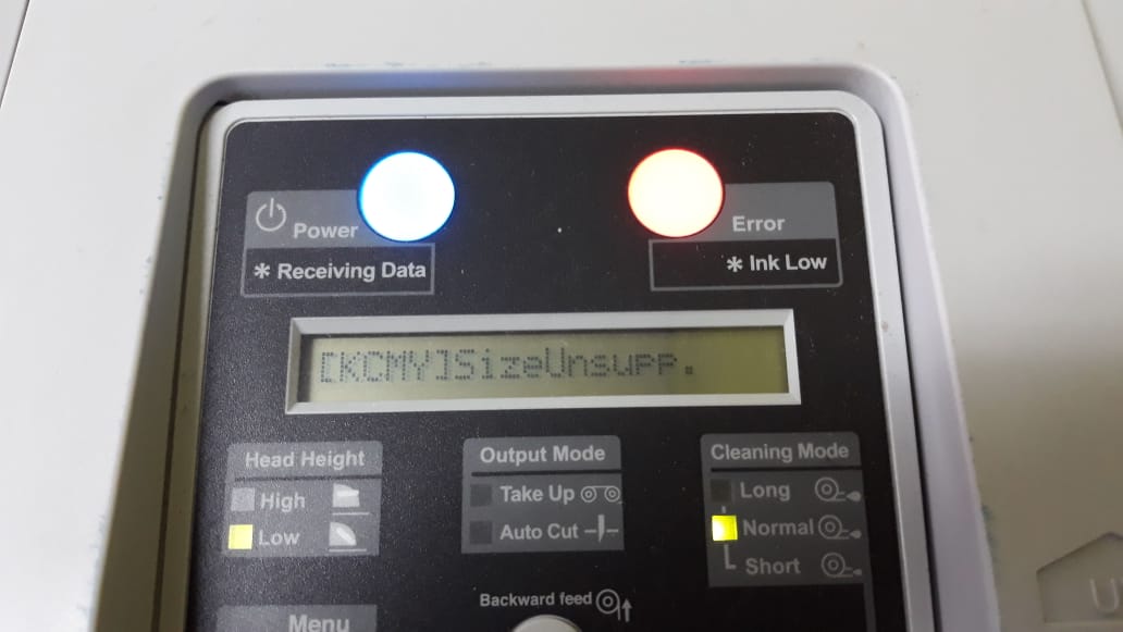

Need Help 1324x firmware downgrade possible?
Keevan
Mutoh 1324x
I just updated the firmware from 3.01 to 3.04 heater from 1.22 to 1.24
Updates were successful but when i restarted the machine in normal mode it gave the error.

I don't have 100% confirmation on this yet but I am pretty sure the new heater firmware for the 1324 series prevents you from using anything other than 220mL cartridges. The reason being that the 1324 series never actually supported the 440mL size even though a lot of customers still used them in the machine. This created the problem of the cartridges not completely emptying and customers would get mad at Mutoh and ask for new smart cards so they could finish their cartridges. Mutoh got frustrated because the manual and all of the specs explicitly say you can't use the 440mL size in that machine so they have updated the heater firmware to stop customers from doing that so they stop getting angry calls. It sounds weird but the chip that decrypts the ink smart cards is on the heater junction board and that's why the heater firmware affects the inks.

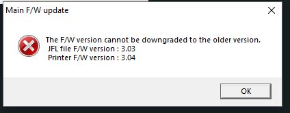

Thanks for your response. so basically i've screwed myself royally here... is there any way to downgrade the firmware?

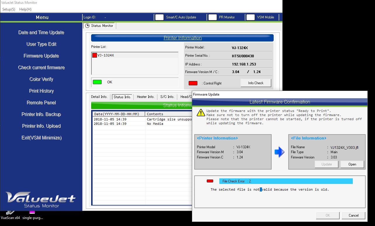

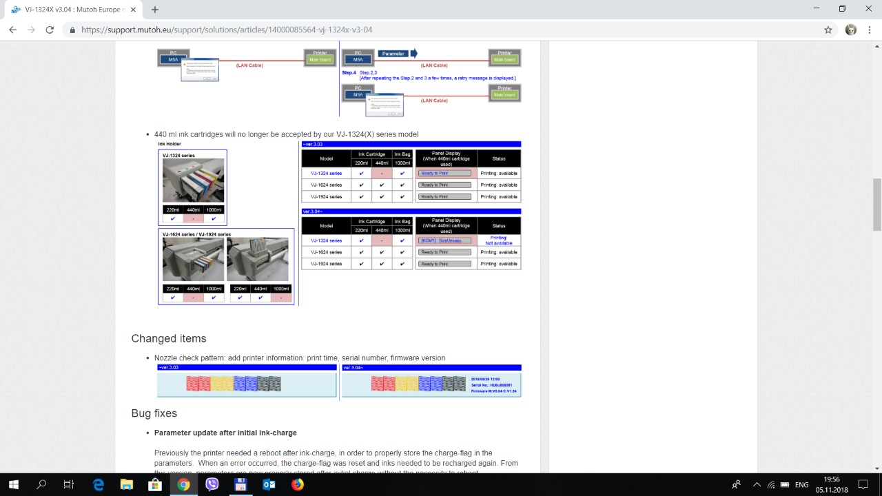

Confirmed that it is Mutoh blocking the 440ml.
Downgrade seems impossible....

I just confirmed with Mutoh that the new firmware does prevent the 440mL cartridges. They did say that if you want to upgrade the firmware and not lose all of that ink, they will send out a set of 220mL cards so you can use up the final amounts of ink left in the cartridges. You just have to ask your dealer to put in the request. They will only do it one time per serial number. They changed the firmware because they were having to send out too many cards to people using the wrong inks.
