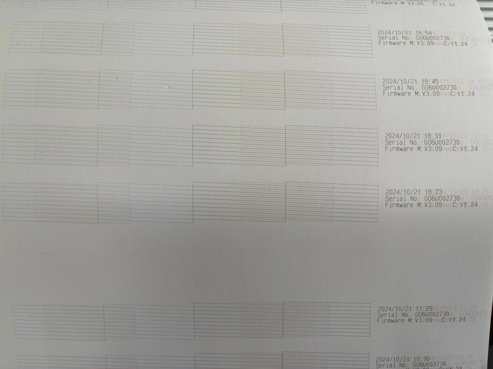

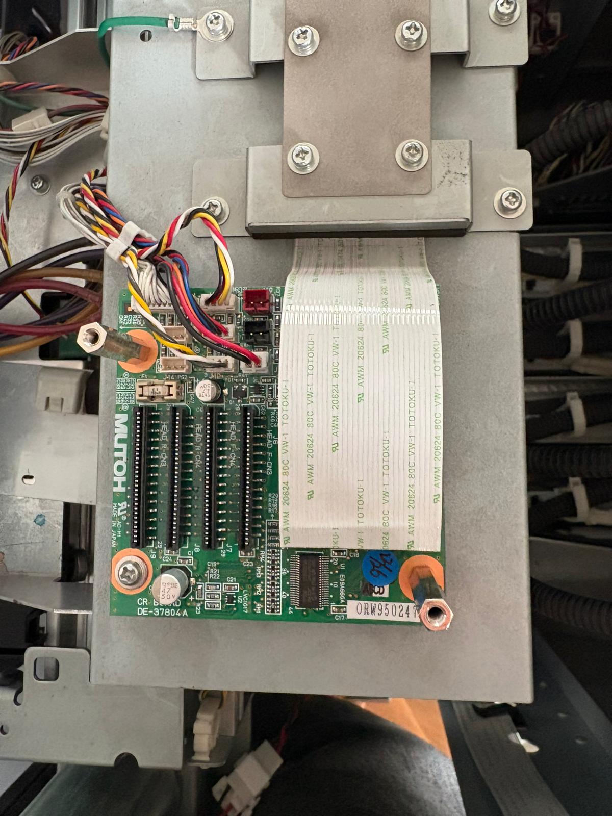

Hello!
Problem is with magenta nozzle check displacement.
I already changed
- CR mainboard
- printhead cables
Thanks for attention

It’s a timing issue. First check service level UniDi calibrations if the magenta is shifted
