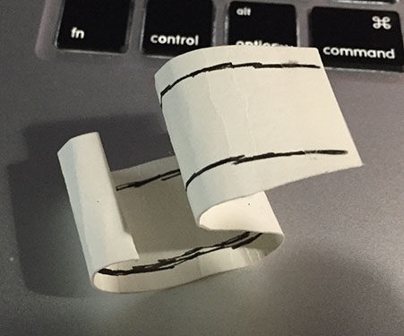

Johnny Best
I would charge $50 just to make a mock-up sample of the ribbon. As others have said, it can be made but you would need a slip roller machine to fabricate with metal. You could use 1/4" acrylic and heat in oven till pliable. For what your getting, $50, just keep it flat and print it on.
