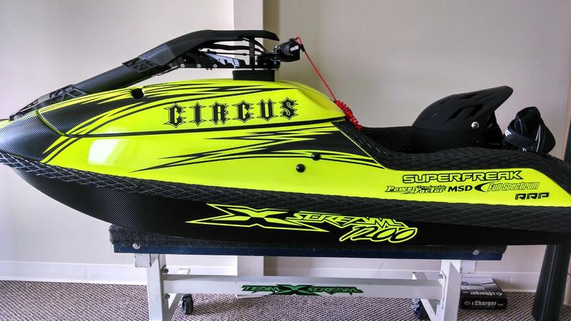

31legen
Durability
That ski was done 3 years ago. The bottom part below the rail is done and held up without issue in water. I did edge seal it to be certain.
rdm01
Impressive. I guess I won't be overly concerned with medium to large detail cut wrapping vinyl.

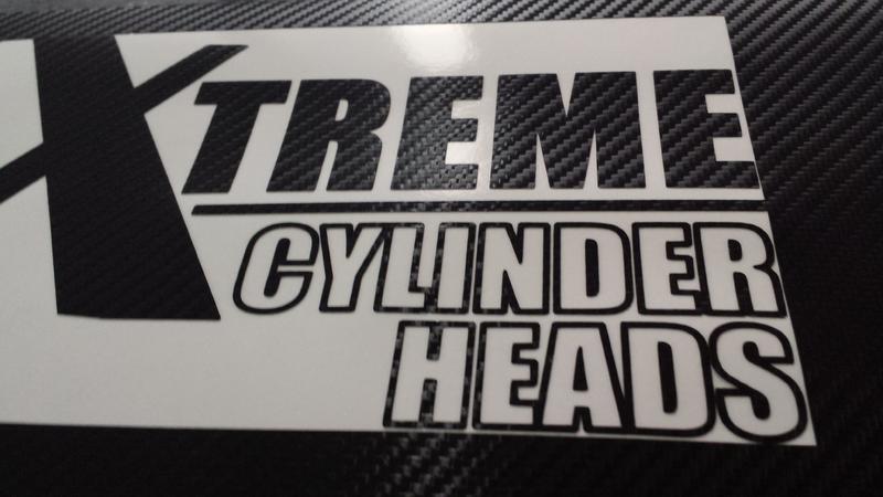

bigblocktrader
Well found my clear transfer tape and yes it works just fine,no heat no excessive hard squeegee Made 100 decals and 25 of them are 1080 carbon,
For those who think it can only be done with med to large decals attached is 8 x 5 with some very small detail letters
