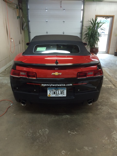

I am doing a color change wrap for a 2014 Camaro and never have used this type of vinyl before (3M 1080 Black Gloss Metallic). I have only printed and installed using 3M180CV3 and others. After starting the wrap job on the Camaro, I started on the back bumper and after getting finished, I am noticing that there are lines, in which I do believe are the adhesive, from pulling the vinyl up and reapplying it. You can't feel the lines or marks, it is just visual in a certain light. I am also using the Firestorm Metallic Red 1080 and it has the same type of marks/lines in it. I assume these are from the adhesive. My main concern is, will these go away eventually when the adhesive levels out? If they don't go away, then how the heck can you put this vinyl down without getting these marks/lines? I can't believe it can be done. So hopefully, someone who has used the vinyl before, can give me any information as to how to prevent these and or if they are going to go away in time. As far as I can see, the only way to prevent them, is not to stick the vinyl down and pull it back up anywhere. I also noticed that when you heat the vinyl up after installing, other lines start showing up as well. These marks have me concerned, because, in all the advertising and hoopla of color wrap changes, I keep reading that it is like paint. So far, not even close to paint when you have these marks/lines that show when installing the vinyl.

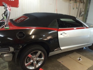

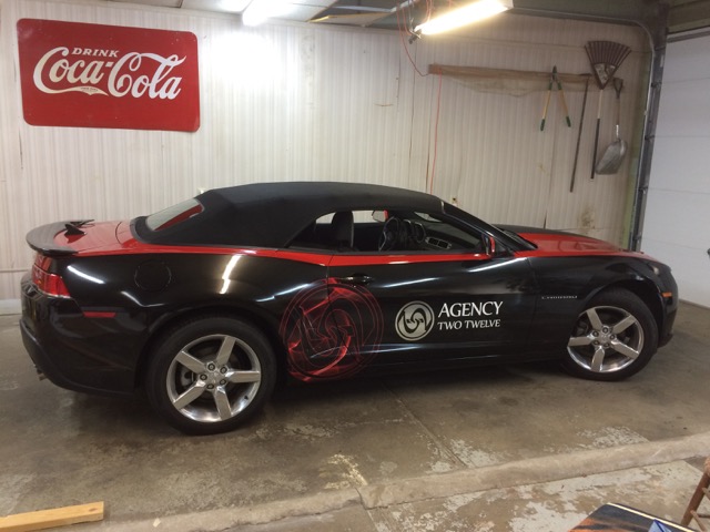

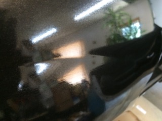

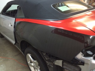

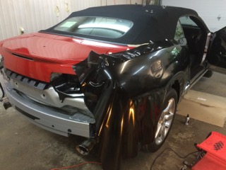

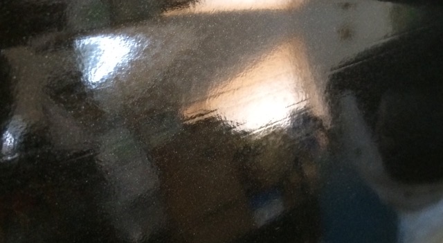

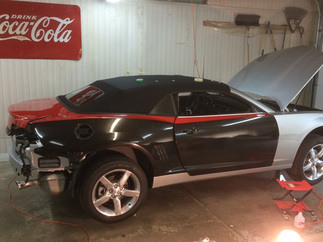

I took many photos, but couldn't get a good photo of what I am talking about, but then found one of the bumper that showed a few lines. Look at the photo with the black and you can see lines in it. I have two photos of the same lines, one is a closeup, the original is hard to see them at a small size. These are similar to all the lines/marks that have me concerned. Some are not straight like the photo, but most are. Check out the photos of what I have done so far. I also have the mirrors, door handles, spoiler wrapped.
I assume the lines was from pulling the vinyl back up, but it also does it when you don't. I proved that yesterday, as I put on the back trunk and it went on like a dream compared to the bumper, and it did have similar marks in it. I also heated an area, with a heat gun at 110 degrees max, and it caused horizontal lines where there was air that popped the vinyl back up. This has to be the adhesive. It seems that the vinyl hates heat as it does this in any area that is heated. So again I am confused. How do you post heat the areas that need it without getting these lines that show up? I still assume that these will all go away as the vinyl sits on the car for awhile and the heat and sun is exposed to it. If it doesn't, then a flawless wrap job with no marks or lines is basically impossible. I am not sure if going to a 3M wrap class would help me out, as I was trained by Rob Ivers. It was a few years ago, but I have done quite a few printed/laminated wraps on vans, cars, trailers and utility trucks. Doing a color change on a vehicle, is way different than doing a printed wrap. Especially when putting black on a silver car, in which any area showing original paint sticks out like a sore thumb. Trimming takes a lot time because of how to get it done to ensure full coverage and no wrinkles. Nothing more frustrating than when you get the vinyl applied, and then ruin it from trimming it incorrectly. But also, when you get finished and you feel you did a great job with the panel and then see the marks in it. Overall, it looks fantastic, until you start to get close up and start seeing some of the lines in it in a certain light. I hope that it is just the adhesive and it will level out over time and look just fantastic. At least I am hoping! Until I can see this car in a few months, I might not never know until then. Anyone with any information of doing a wrap with 1080 3M Color Wrap vinyl, and their experiences would be much appreciated! Thanks All!

never seen marks like that before, they are really straight compared to what I get sometimes, did you for example squeegee it hard then lift it? in that spot
what kind of squeegee are you using?
did you ever try any 1080 regular gloss colours ? if so did you get any of the same marks?
redprint
I have not used any other colors of the 3M 1080. This the first time I have used it. I have the Black Metallic Gloss and the Firestorm Red Metallic Gloss. Both do the same exact thing. And yes, I have squeegeed some of the spots, pulled it up and squeegeed again, but like I said, it has the same marks in the vinyl that doesn't get squeegeed and pulled back up. It seems to have marks if your vinyl gets any kind of bend, while trying to position it. Any type of stress that doesn't keep the vinyl flat seems to do this also. Like if you have a large sheet and you are positioning it and it bends a little, then you see the bend in the vinyl. I can heat it up and get rid of the bend, let it cool and squeegee it down. So tell me this, do you put all the vinyl down without getting it stuck before hand, and never have any problems with compound curves, difficult angles etc? Do you never squeegee the vinyl down and then sometimes have to pull some of it back up? I really can't see how you put any vinyl down, without getting it stuck somewhere and have a wrinkle that you have to get out. Not all surfaces but the compound curves, indentations, vinyl sticking to the moldings, etc. I don't see how it is possible never to have a problem with putting the vinyl down where you are going to have some types of problems in which you will get it stuck before you want it to or it gets a little bend in it because is didn't stay flat. Also, like I said, when you heat the vinyl up after it is squeegeed, it starts to get lines in it that are very apparent. Makes me wonder how you post heat this vinyl if this is what it does when it heats up.

Okay! I finally figured it out! My body shop guy who removes the body parts came over and looked at the lines and immediately says, those are sand marks in the body. Apparently the car had been in an accident and was repainted on the back end. The people who repainted it, did not sand correctly I would presume, since you should have a smooth finish. The sand lines transfer thru the vinyl. I never had any other issues like this after getting the rear end finished. The front had none of these lines/marks.
