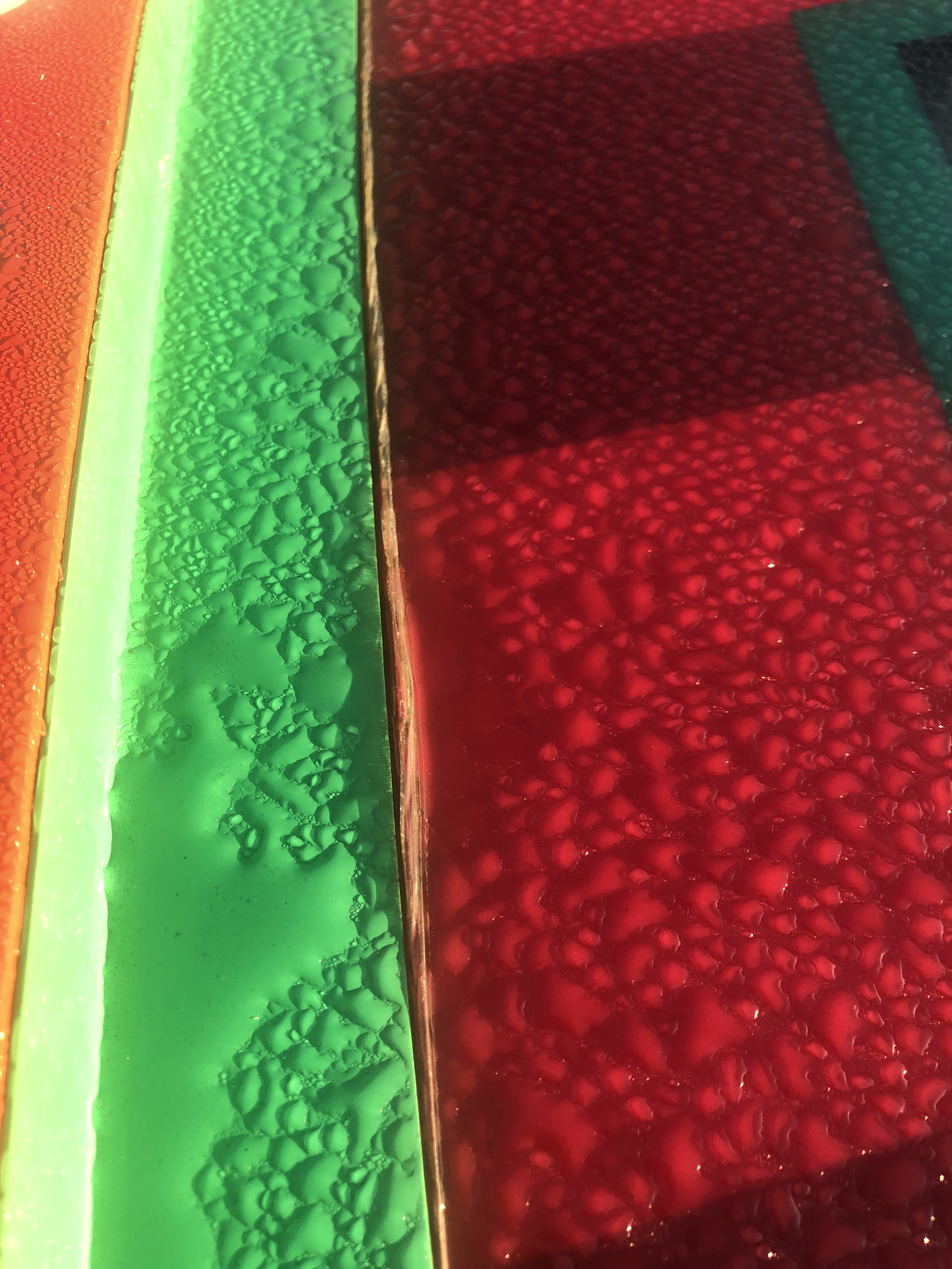

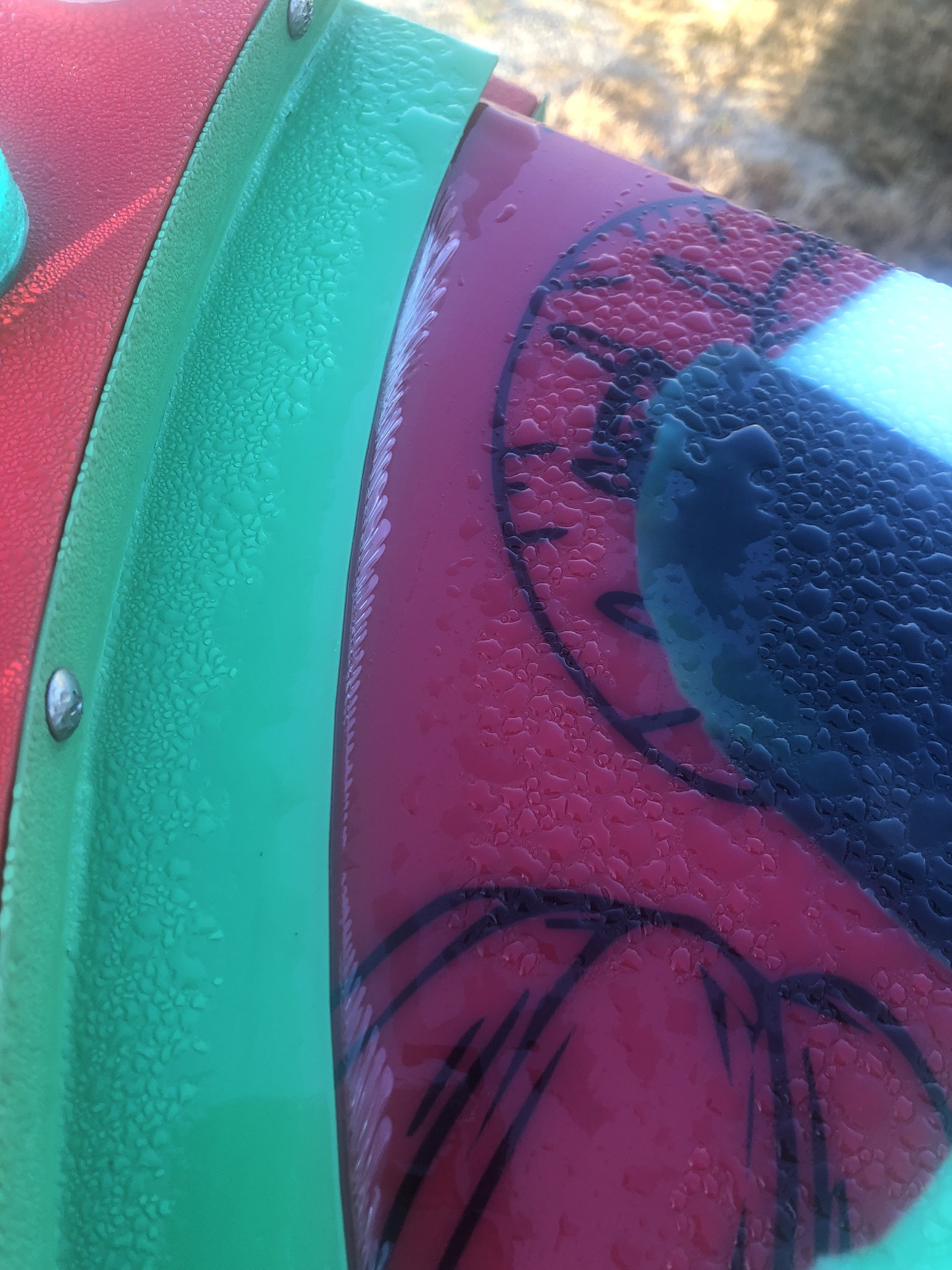

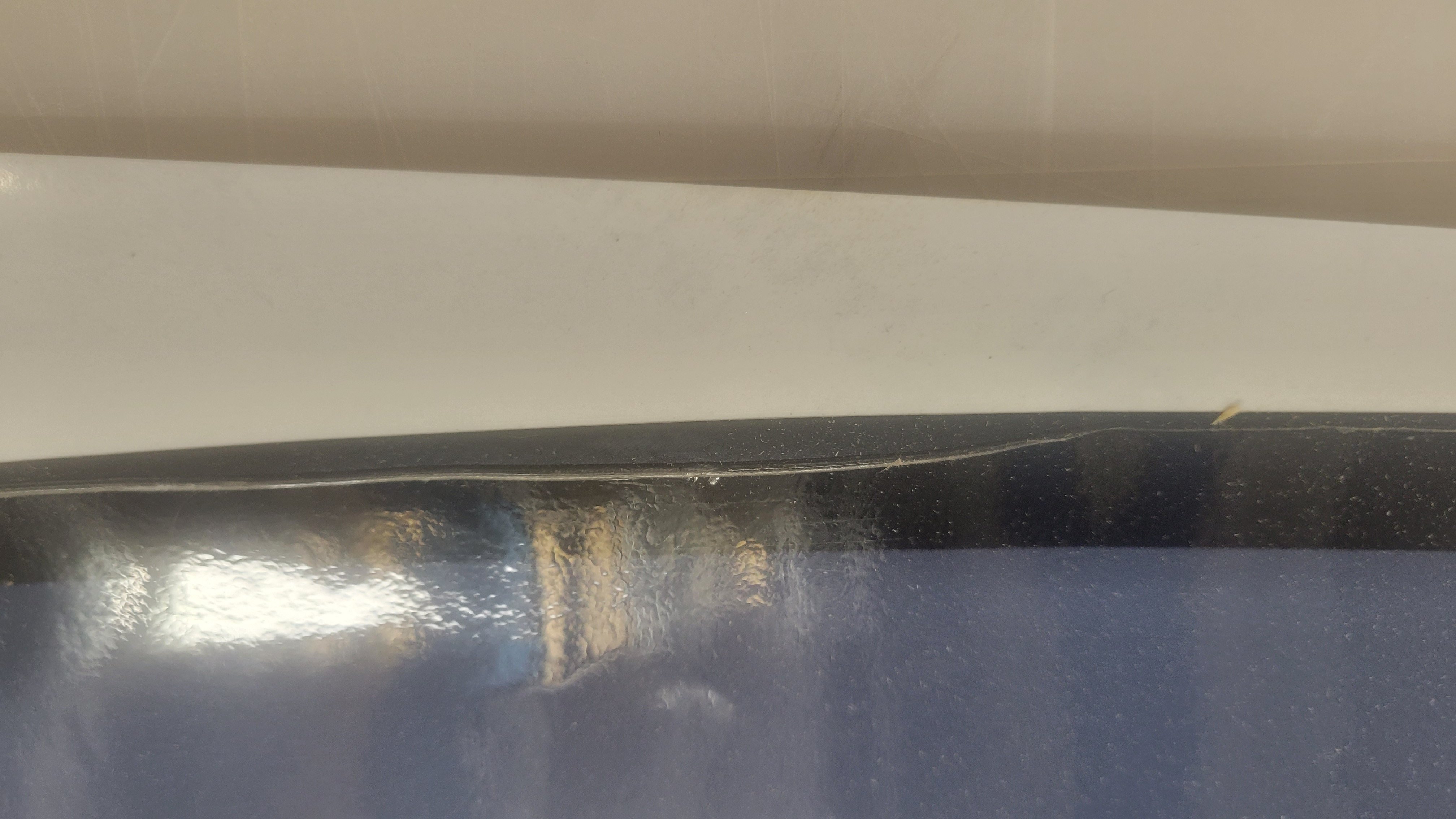

We are having trouble with laminate peeling off our printed vinyl. I will attach pictures for reference. We do have angles holding these signs in so friction could be an issue but we have done it this way for years and most have no problem. We are printing with HP LATEX 315 Printer onto 3M IJ180 Clear Vinyl and LAMINATING with 3M Scotchcal 8518. This is outside in the weather at all times. Any advice would be appreciated. Thank you!

DrunknMonk
slow down the lamination to 0.5 pmt, a bit of heat laminating helps to, but the main thing is to drop the profile ink limits to 90% or 100% at max, if its at 110% its to much, the anti scratch coating is in the ink, so more ink more anti scratch more de. lamination.

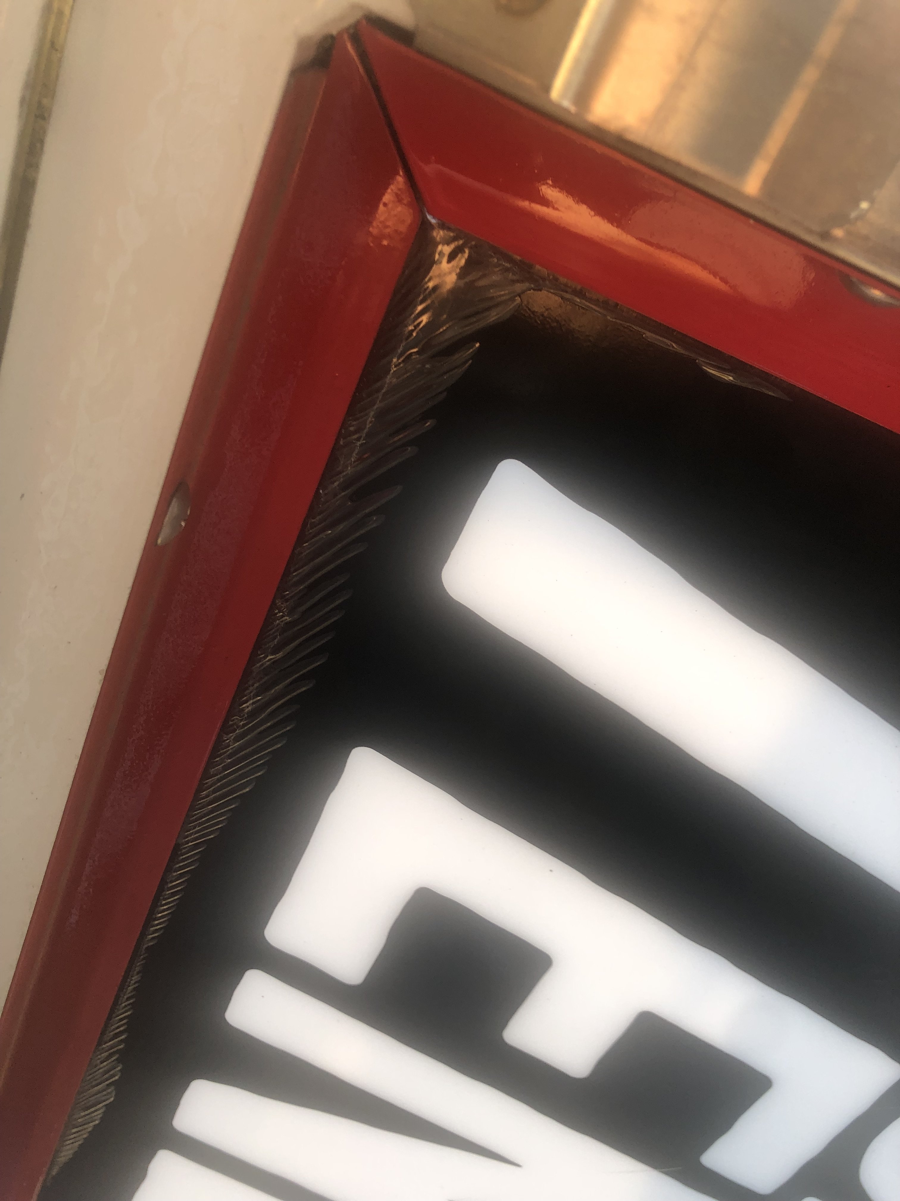

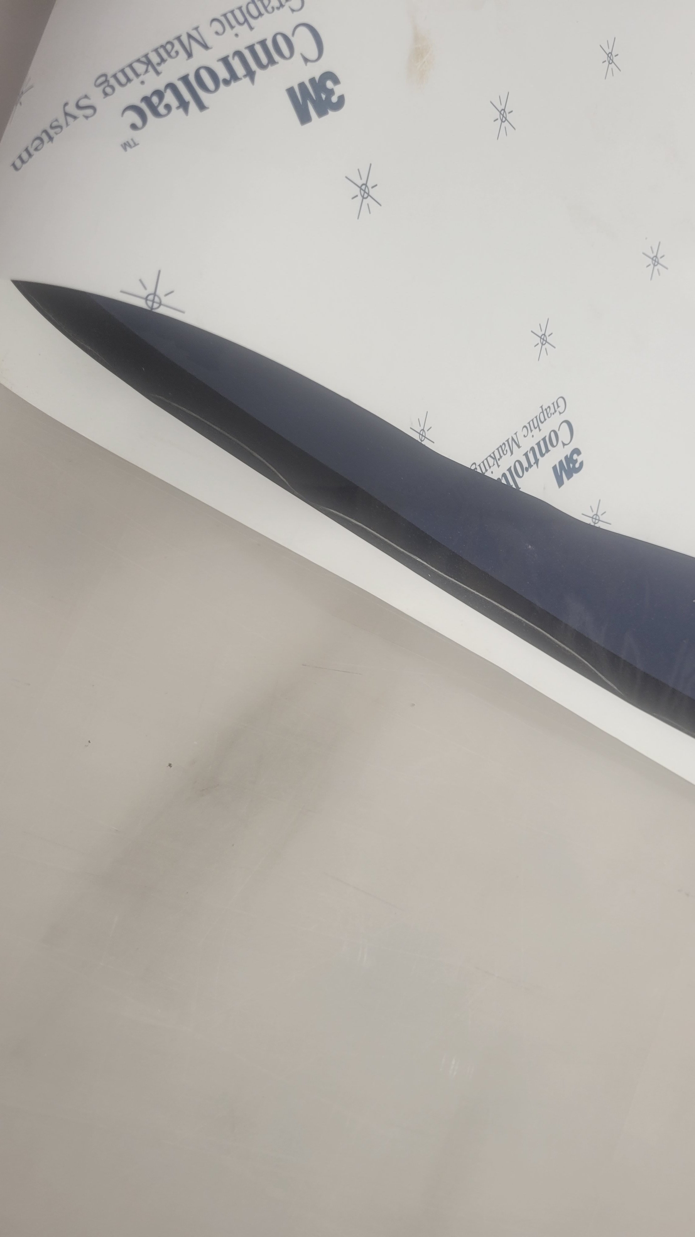

dasigndr
we had the exact same issue with the exact 3M materials.

zillion29
This is the first time I'm hearing about the existence of anti-scratch latex ink. If that was the cause, wouldn't we see rampant IJ180/8020 fails? I've never seen anything like the OP's issue before.
It's a known problem with 3rd gen inks. And it's not only one material, you can have the effect with any vinyl and laminate with high ink load. It's rare but can happen.

greysquirrel
peal 3 looks like contamination under the vinyl, no? what material is this vinyl being applied to? Peal 1 what density is that black? If its over 350% saturation, that could be the problem. Did you use a torch to set vinyl after applying? what profile are you using, printmode density pass heat etc?

DrunknMonk
we have been having it since we first installed the 365, HP came to site, this is what you need to do to make it better, it won't fix it, but its better, (slow down the lamination to 0.5 pmt, a bit of heat laminating helps to, but the main thing is to drop the profile ink limits to 90% or 100% at max, if its at 110% its to much, the anti scratch coating is in the ink, so more ink more anti scratch more de. lamination.)
