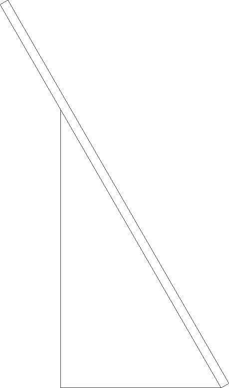

The easel backs from Uine are fine but you have to buy 3.
3 mm coro will work fine.
  • easel cut template.pdf

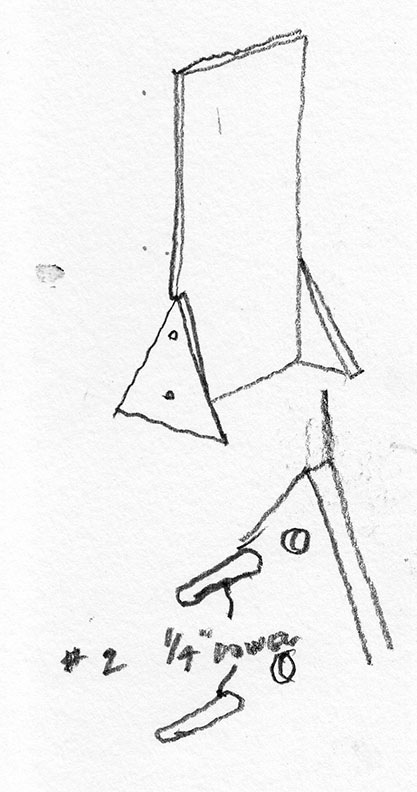

Johnny Best
Cut two triangles out of same material. Line up with large pabel and drill holes thru triangle and sides. insert dowels.

Boudica
i don't know if that one will work or not. The substrate needs something to hold it upright. it's not as stiff as acrylic.
It would work with gatorplast.... but overpriced and overkill for the purpose. cardboard easel would work fine, maybe two. You can either use a template to make one, or fashion your own out of cardboard, foamcore, coro, more gatorplast.... whatever you may have large scraps of.
