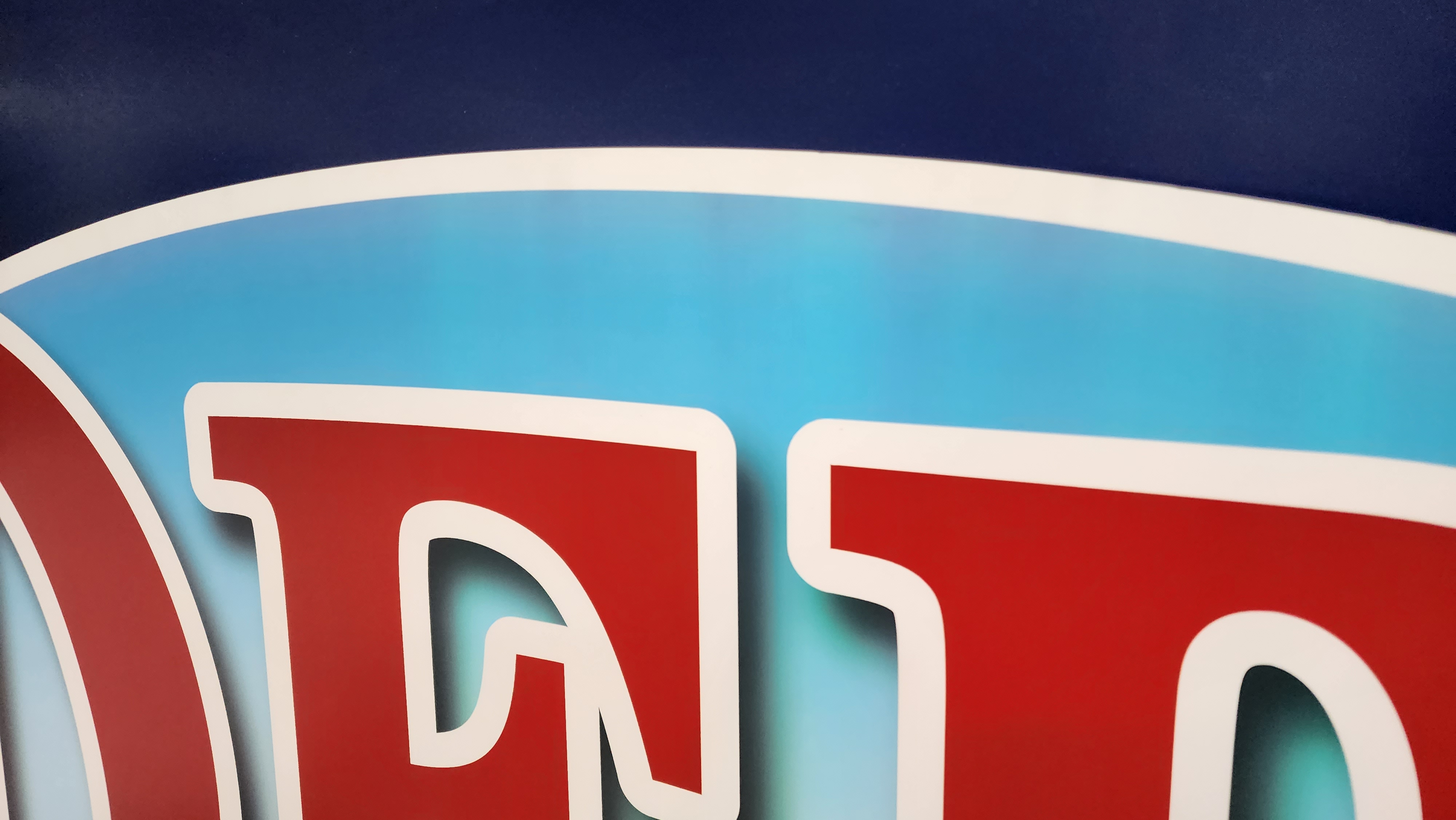

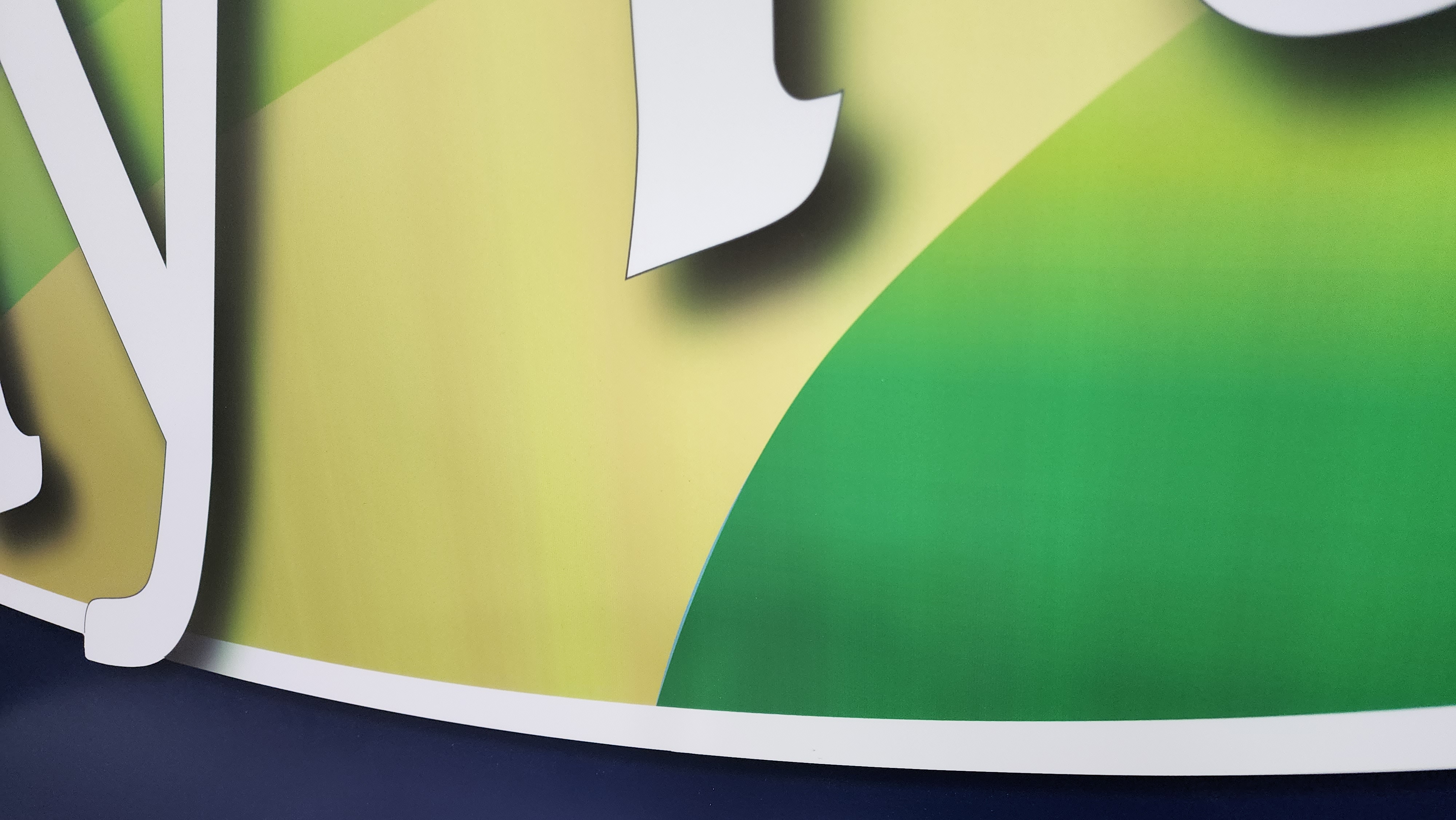

Edit: I have added some pictures showing the ink starvation. In the solid colors of the background you can see the inconsistency of the color. Does this look like a printhead issue? Ink flow issue? Profile issue?
