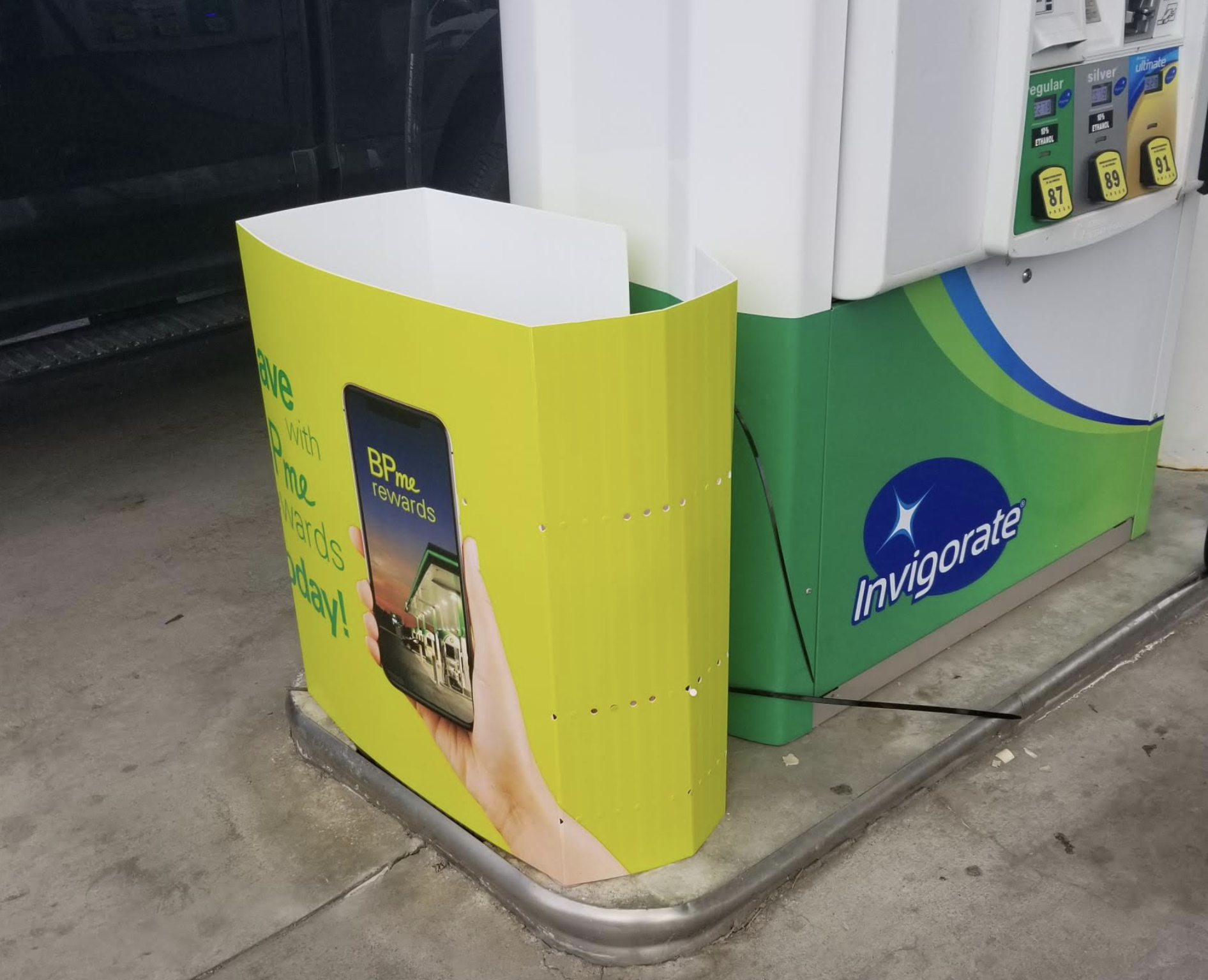

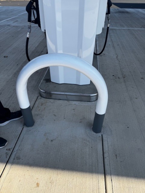

we have been asked to make some "wrap arounds" for the pipe protecting gas pumps
(see picture)
can i get white coro with flutes running on the 4' dimension?
then i can use a coro claw and slit one side of the coro and wrap around
otherwise, what would you use to join 2 4' pieces together ? grommets?
the image will be 36" x36" & with the flutes running "the right way"
i just need to reinforce with a length of white "gaffer tap" and add a few ties
to attach to the pipe

You most definitely can! I have a full skid of it on my floor for this exact purpose. I believe Grimco stocks it and you can get it by the sheet. I get ours by the skid from lindenmeyr.

seriously, though, slit i side of the flute, in four places, making a rectangle, (the way the supermakets make end of aisle displays) then put a length of 2" gaffer tape on the inside, reinforcing the inside seams, and allow a 2 inch overlap, with banner tape (the 5th side) to close it off & put 3 grommets in, on the 2" overlap it should hold up for quite a while.

You must never visit gas stations. These are everywhere and we have printed 100s if not 1000s of these on corrugated and banner. Corrugated is a perfect cheap outdoor material for this.
Like OP said print direct, score, trim, pack and ship. Extremely easy and profitably product.

Seen quite a few. Fairly recent marketing idea. Thick coro with a direct print zip tide to the guard posts on a gas pump island. Cheap enough to replace when or if damaged.

Yes. If you order from a place that lets you use a full sheet (4' x 8'), the flutes go the 8' length, you just make your designs go the other way. Signs 365 is easy to use. If it is outdoors, I like to spray mine with SEM color coat Clear #13003. protects, seals and makes it last longer, However coroplast degrades and cracks up if exposed to outdoor weather condition for a few years.

1.) This is a common product. It will last as long as a typical promotion - 1-3 months - without any issue outside if you make it from corrugated plastic. (
2.) Reverse flute, short flute, ~48" flute corrugated plastic is reasonably common. We stock a half truckload of it here at FireSprint for 18x24" yard signs. Many sign suppliers stock it, but you need to ask for it specifically.
