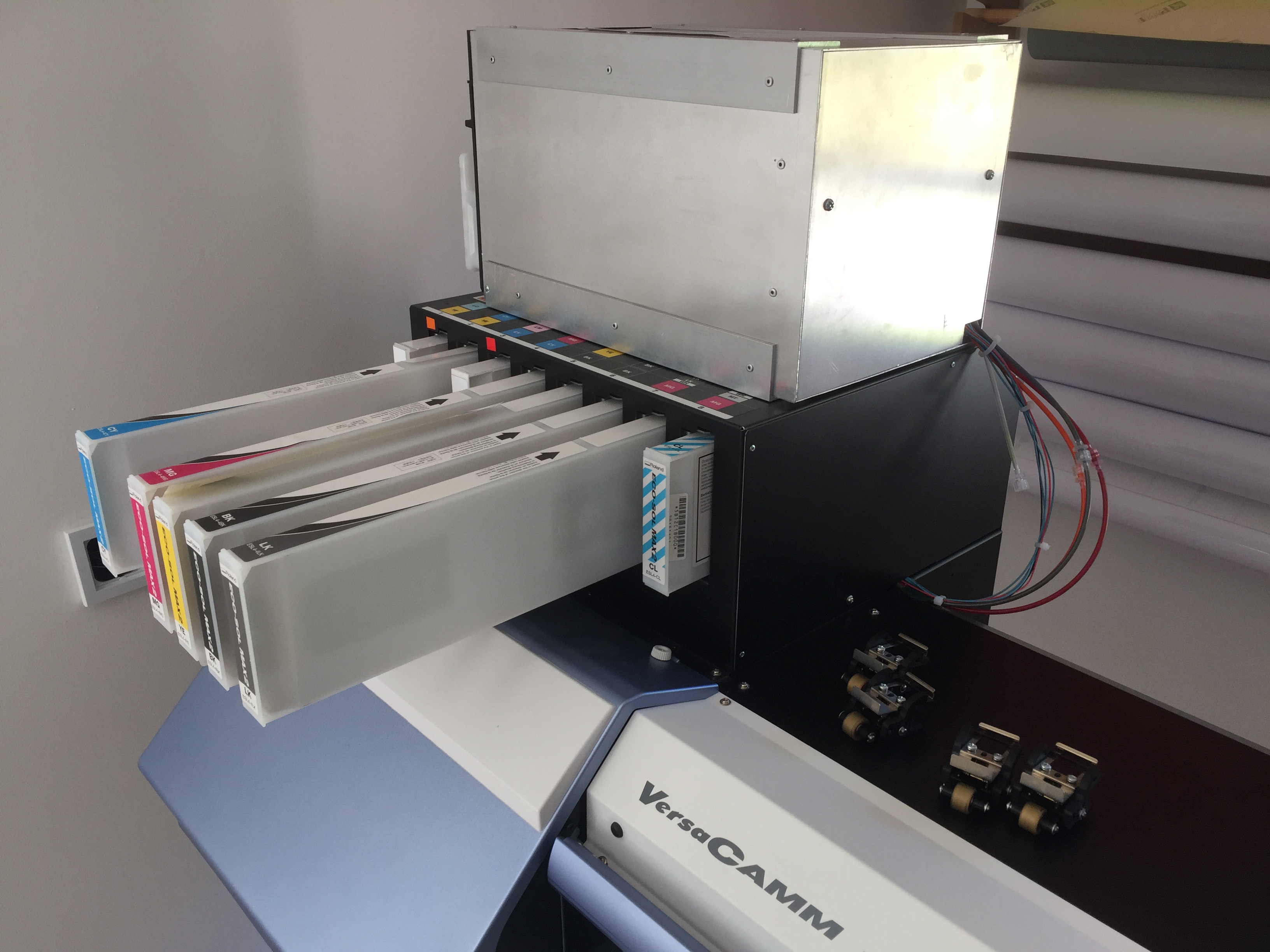

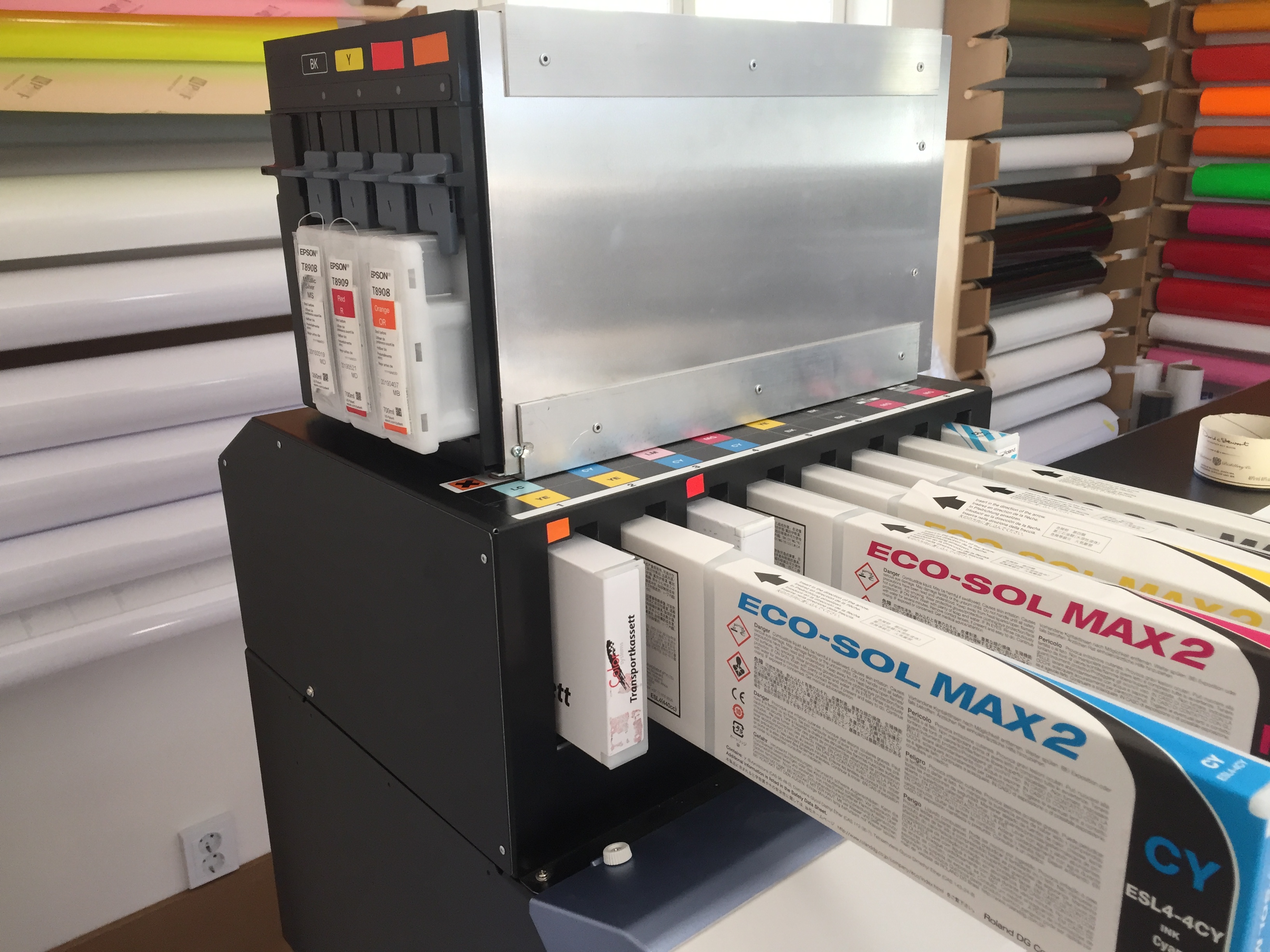

The printer is a VS540. Really we needed the orange ink to hit Pantone 021c so that's why we use Epson inks. So we run Epson orange, red and metallic along with Eco Sol for CMYK + LK. Everything is run using Onyx and the profiles were done by a company in Stockholm where we buy all our equipment, inks etc. It's a pretty good setup. Not as fast as an Epson but that's not important for us. The range of colours is awesome. Now we just need to figure out a way of replacing the LK with the new Roland green ink and I think we could hit 99% of Pantones :)
Here are a couple of photos of the setup. Looks a bit home-made but it works.

I am taking it you are using channel control in Onyx to take over the LC LM channels? Have you looked at using the aftermarket green ink for the Epson GS6000 if you can grab and control the LK channel? I know on the old rolands there is a way to run orange and green instead of lc and lm without channel control rips but I did not know the newer versacamm would actually take the epson ink. Keep me posted I am curious. I am about to drag in a XC540MT and refurbish the whole thing testing with inks and channel control. I also need to hit 021c and some other colors.

Yes I'm pretty sure that's how it works. I didn't create the profiles myself so I'd have to confirm. I did look at the GS6000 ink but I would need to build or find a different type of holder for the cartridge. I'm hoping that the latest Eco Sol Max 3 green can be inserted in place of the LK to keep things neat. I'll update this thread if I find a solution.

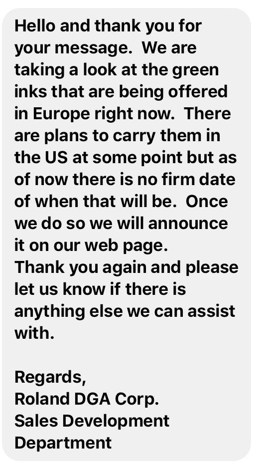

I did check into this with Roland DGA here in the USA and their response is attached. Looks like you guys will be getting this option before we here in the USA will. I am sure they want to limit liability in case it causes major problems with those DX7 heads.
If you can ask your dealer who is setting up your machine if this option to add green ink will be available for the previous models Roland XC540 machines as a oem option for Roland as well. For example can you ask if they can get a firmware upgrade for later machines to also run green ink. If that is confusing can you PM me their contact info?
