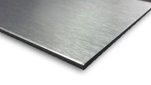

i saw a sign with Aluminum Composite backing when we are removing it. i have never used even that material is half price of .40 Aluminum itself.
Also people are making monument signs from ACM materials. what is the disadvantages of using it outside ?

Some of the brush aluminum ACM finishes like the one pictured are not outdoor rated.
