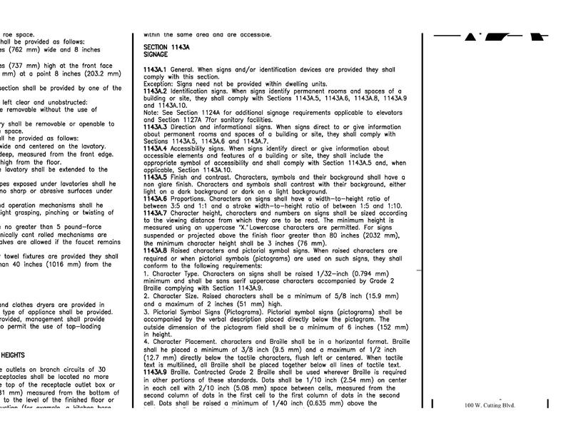

i've done residential buildings in san francisco and private residential units don't need them.
California Building Code, Title 24, Part 2, Chapter 11, Section 1143A (attached) specifically 1143A.2
moc_os
chapter 11B applies to Accessibility to Public Buildings‚ Public Accomodations‚ Commerical Buildings and Publicly Funded Housing
edit: i see it is you posted 11A. anyway it does say to comply to that section but that section doesn't explicitly say ADA signage is required. for example it doesn't say raised characters are required, it says WHEN raised characters are required.

J Hill Designs
"when signs identify permanent rooms they shall comply with 1148.5 (contrast) 1148.6 (size/proportion) 1148.8 (raised chars and pictorials) 1148.9 (braille)
