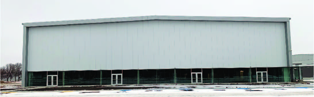

This is where the Halo's are supposed to go, for reference. It's a 48' wide sign...

something that big would need a massive raceway/wiringpanel....which would require drilling the wall as well.
if they're hellbent on it, you could easily install some framework with minimal holes either from the roof or through the wall, but they're hmm & haww'n their way to a $5-10k+ upgrade.
if you did go that route, however. its GOTTA be a panel. just throwing reverse-lit lettering on a simple raceway looks absolutely awful when it casts that hard-line shadow across the fascia.

I would think your best bet would be to install the letters onto background panels. Build a mounting frame that attaches to the wall with a lot less holes than individual letters. You will end up with much better lighting as well. Also, they would only have a single point of power going thru the wall as you could do all of the wiring behind the panels then run a single wire thru the wall. No way of doing something like that without drilling some holes in the wall, at least not in a cost effective manor lol.

i'd also be worried about attempting to mount any structure to a fascia, where the client has potentially demanded the contractor assemble the building without using any mechanical fasteners.
