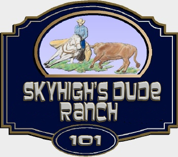

Now you have me curious Gino. Do you feel a plain piece of alumalite looks unfinished / bad?
Typically for wall signs (this is going on a corrugated steel bldg), I would make a pan face out of regular aluminum (thickness depending on size of sign). Being this is over my 10' brake capabilities, Im forced to do a flat panel. Tell me... would you typicall make some time of frame for a project like this?

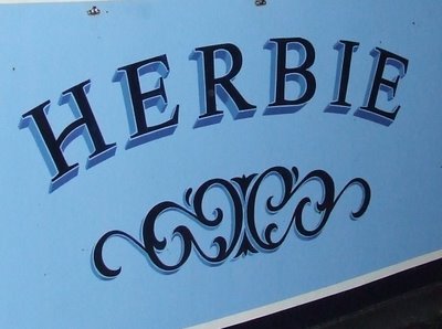

At the size of your sign, I would either paint or vinyl about a 2" stripe or so to make it look finished off. Sometimes, we'll do a 2" stripe and then a 1/4" keep away stripe in anther color according to the look of the sign.
Keep away's are shadows, stripes or gingerbread that sets in a slight distance to add depth.
