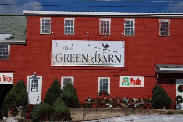

Ive used this system and it worked well.
http://www.tiffinmetal.com/AVP/Catalog/?a=c&cid=22
After the brackets are mounted you can change a large banner quickly, but I'm not sure if it would be cost effective on smaller banners.
I believe it averaged about $20 per bracket, and you would need one every 30 inches on the perimeter.
steve
