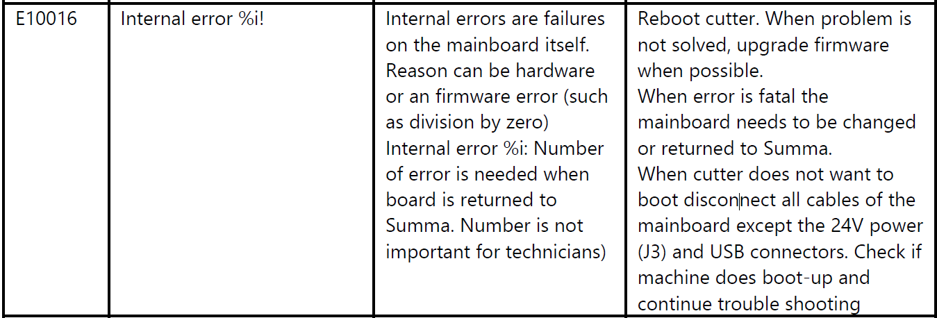

Below is from the service manual. Is there something specific that you are doing that is causing the error? When does the error show up?
E10016 Internal error %i!
Internal errors are failures on the mainboard itself. Reason can be hardware or an firmware error (such as division by zero)
Internal error %i: Number of error is needed when board is returned to Summa. Number is not important for technicians)
Reboot cutter. When problem is not solved, upgrade firmware when possible.
When cutter does not want to boot disconnect all cables of the mainboard except the 24V power (J3) and USB connectors. Check if machine does boot-up and continue trouble shooting.
When error is fatal the mainboard needs to be changed or returned to Summa.

What Chris suggested is correct. Here's the exact snippet on the error message from the service manual -
PHILJOHNSON
Sales Manager
So, you could try updating the firmware first, but if that doesn't clear the error then you most likely will need to replace the mainboard.
