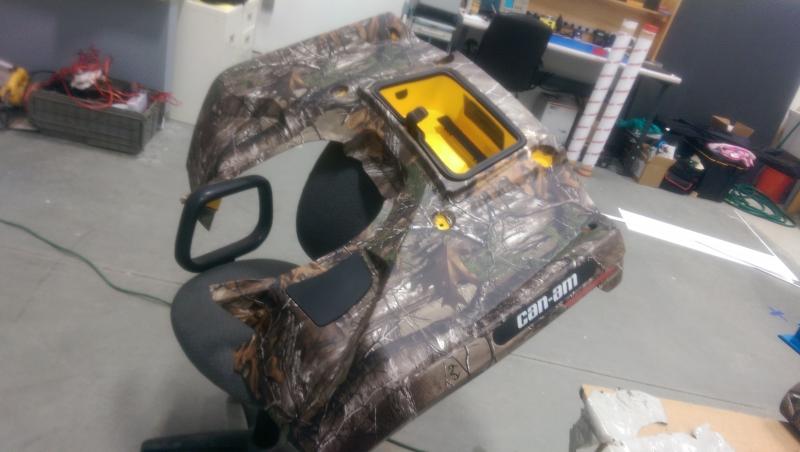

I see what you mean. The sharper corners don't hold for squat without the primer. The primer is a must. This is the rear. One piece or wrap.
The bottoms and any yellow you see will be done in Krylon Fusion black by the customer.
Next time...I'll be hydro-dipping these kind. Not worth my time to wrap them. The front fender was 10 times as hard. Even 3 piecing it.
