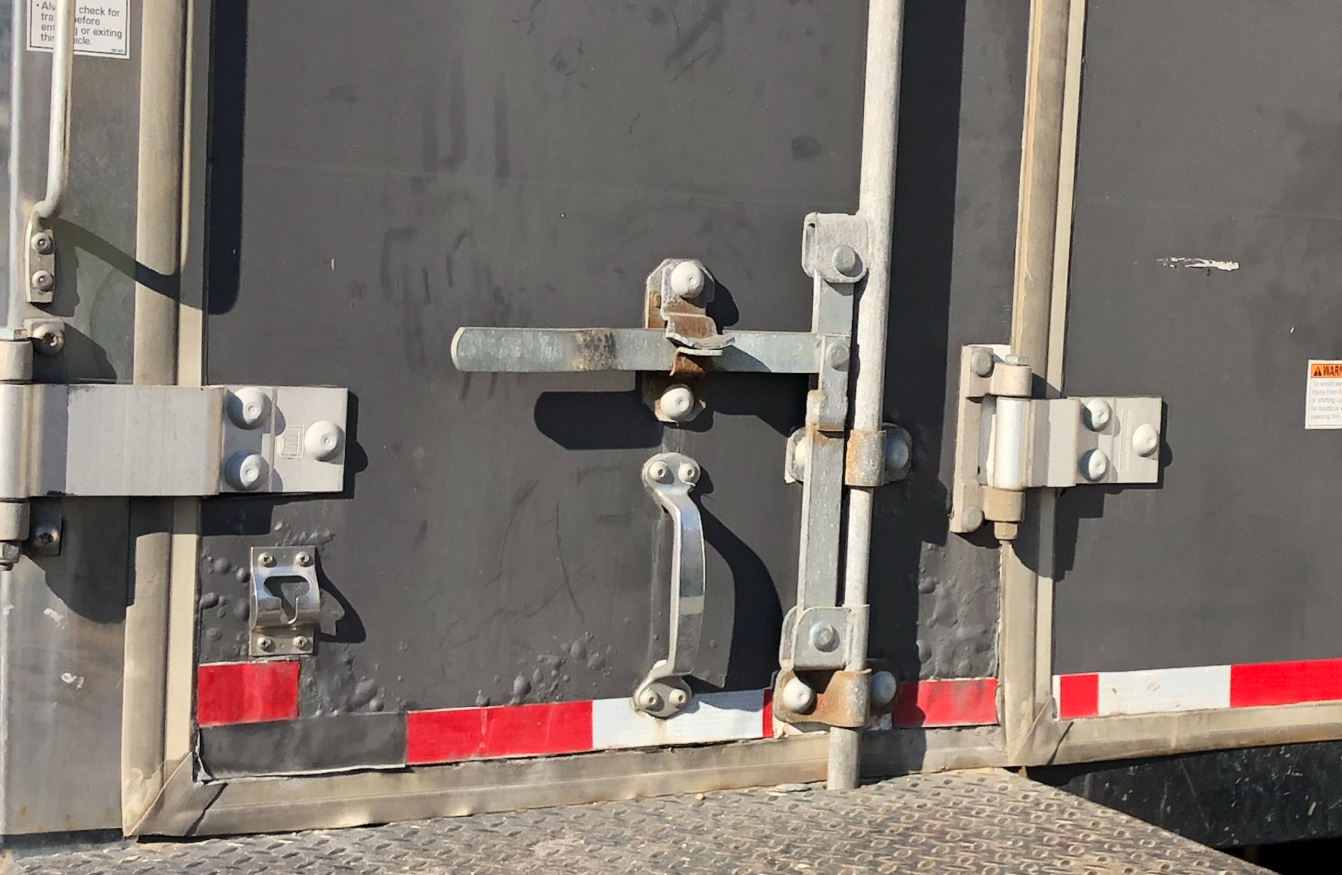

Anyone ever see this?
datoshway
Attached
Jester1167
They do that without vinyl especially when the seals around the doors are bad. there is cheap plywood behind the thin metal and it gets wet and holds water. Typically the lower sides and bottom are the worst.

Looks like run of the mill corrosion. We see a good deal of it here on trucks that are not wrapped. Even the stainless trim corrodes down here at sea level. Unwrapped hardware on the truck looks like it is well used.
It is pretty hard to cut through the powder coat/baked finish during install, unless you had a very heavy-handed installer.
If that was the case there would be a lot more damage at most of the trim edges.

Very common, as said its plywood skinned with thin aluminum. The bottom of these doors leak where the latch hardware goes through and it gets tons of road spray at the bottom.

Typical rear door problems seen on all truck/trailer doors. Those bottom edges see tremendous vibration and hits causing moisture intrusion to door laminates. Not a wrap problem.

Inside-out corrosion. We see it all the time when trailers come in. Has nothing to do with the wrap at all.
Yep, definitely user/application error. Tell 'em to go get it fixed and you'll re-wrap that section at cost........ but he'll have a seam.
