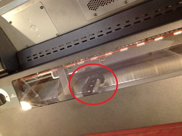

Try the following:
On the right side of the printer, below the window at the front panel, you will find a small silver tube (enclosed picture shows the same situation on a 280). This is an infrared temperature sensor.
If possible arrange your print that the sensor do not measure on printed area. As soon as this sensor measure permanently on media white (or on printed area of the same colour overall), you will have a much more accurate printing length.
but, printing length accuracy depends on the media itself too.
Hi Frank. Typically this is not an option for me, since I'm usually using the entire banner surface and they're rarely solid colors (especially toward the edge where the sensor is). Thanks for the info though.
