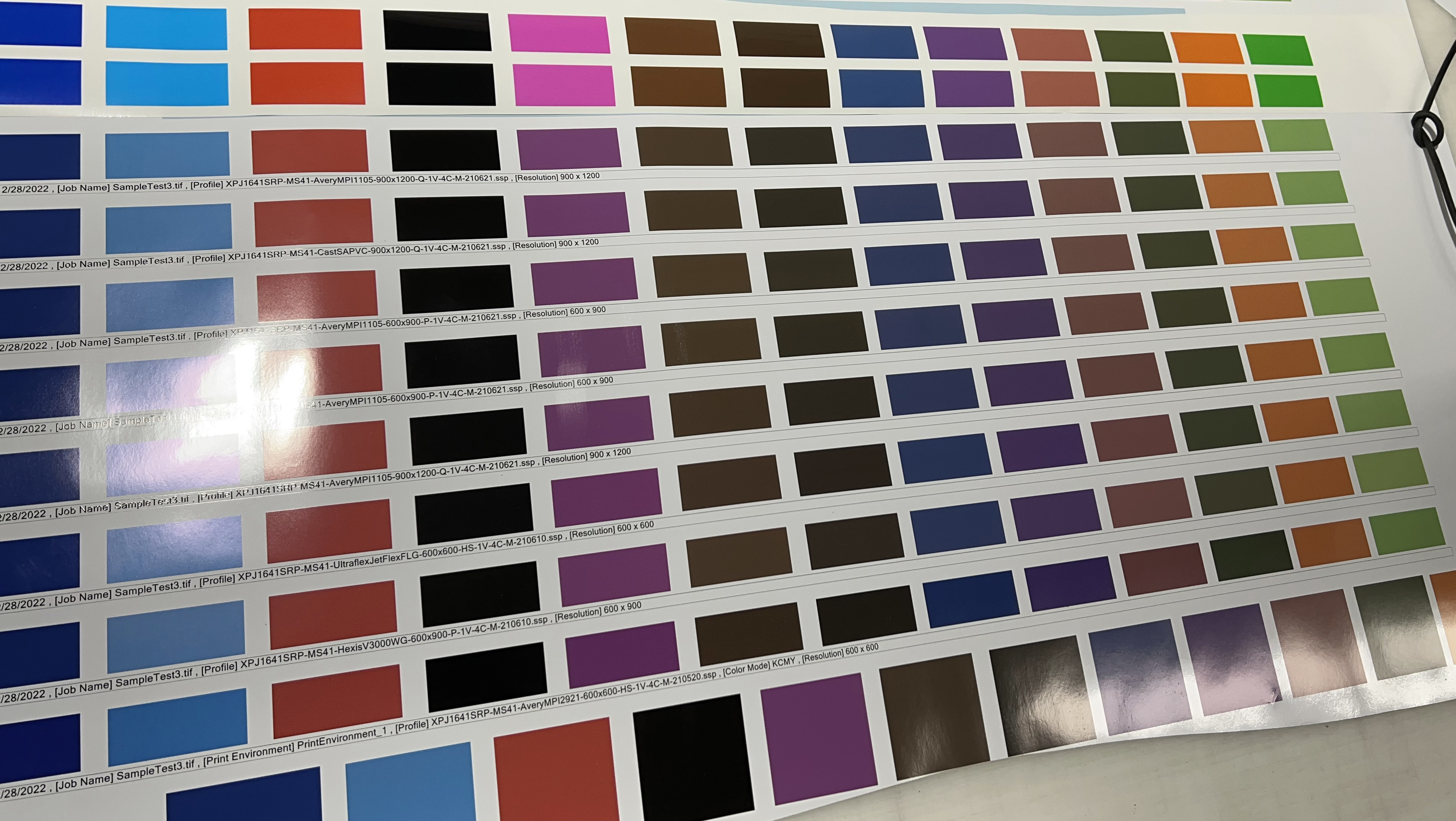

Here is an example of how this printer prints out of the box. The top two rows are just a random profile from my Mutoh 1624 at 720x720. The rest of the rows are all various profiles and resolutions from the 1641SR-P, almost all of which were printed at higher res than the old mutoh. The phone camera altered it a little but in reality the top 2 rows are even more vivid / rgb lookin and the rest of the rows are even more dull. The pink and far right lime green in reality on the top 2 rows is super hot pink and bright bright lime green. I tried all of the media profiles as well as every single one of the ~15-20 RGB icc profiles (not pictured) in the new 1641SRP and none come even close to the gamma range of the old one.

Sorry to hear of all your issues. This really sounds like the reseller whoever sold you the printer dropped the ball. It is the responsibility of the reseller to work with the customer and to provide adequate profiles to work with. We just installed one of these printers at a customer yesterday and the software and the printer worked quite well. They had a 1624 which they traded in and are very happy with the speed and color fidelity of the new 1641SR Pro printer. We as a reseller though calibrated the printer and created several different profiles for the media they are printing on. So my first call if I were you would be the reseller that sold you the printer as it is their responsibility to see that is functioning as it should and they didn't do their job.
