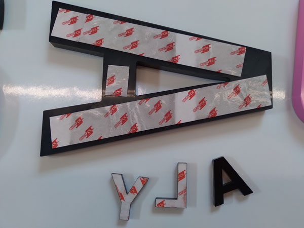

I'm going to do an install of some acrylic letters from Gemini. Interior wall tape mount. Some of the letters are pretty small and have the entire backs covered with mounting tape. Should I use silicone in addition to the tape? It was my understanding to use some dabs of silicone in areas where there's no tape. Can silicone be applied on the tape? And is it recommended to hold everything in place with masking tape across the faces for 24 hours to let the adhesives cure, or can I just install and be done with it? TIA.

Maybe it depends on the wall surface? Painted drywall in an office is where I'll be installing. 1/2" thick acrylic, I think the tape will hold okay as Moze mentioned. So yay or nay on dabs of acrylic on spots where there's no tape?

I'm going with tape only. If Gemini is sending these out with Orajet tape I'll take their word for it. They've probably tested different tapes with different sizes/weights of acrylics and deemed it good to go.
