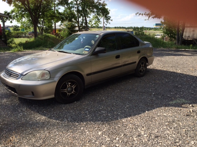

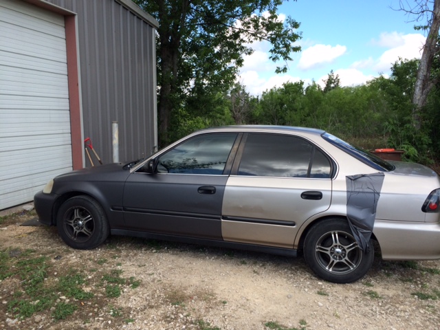

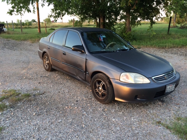

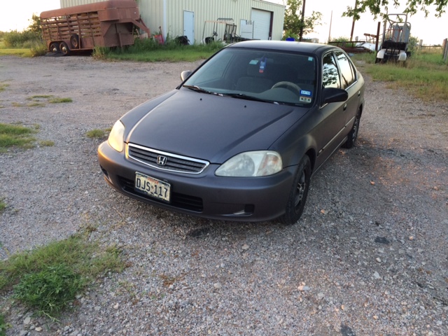

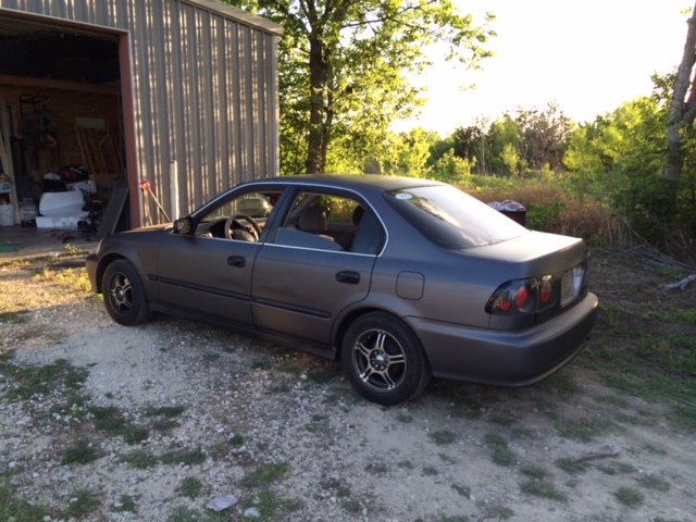

Well Fellas, Here is my first actual "Full" car wrap. I'm pleased with the turnout! I took my time, was patient and had a buddy hold the heat gun and help peel off the backing paper... Personally at 19 y/o I think I have a lot of room to go but am anxious to explore more to the wrap world and eventually offer them at my shop! Attached are the pictures I took now that I think about it I did not get a rear shot and I'm actually proud of the rear bumper and the license plate bracket. I'll add one of those when the sun comes up.

From the photos it looks pretty good.
I think you may have used too much squeegee pressure on the passenger side...

You mean the dent? Or me actually applying the vinyl with to much pressure? The dent came form my high school days....
mbarden
I would have gone to a local junk yard and gotten a replacement door fiirst. You finished product will look only as good as your canvas. Very difficult to turn a sows ear into a silk purse. But,....... That being said im sure your got some great experience wrapping your car.

doesn't look bad, how did you do the hood and the corners of the panels?
The hood I had propped open with a 4x4, so I could open and close it with no problems if needed, witch it was. than I treated the nozzles on top like rivets almost then cut tem out.
The corners I wrapped them around the edge, and heated them up.

Looks good from far....wrap quality is impossible to judge without close-ups. No one ever provides close-ups.
