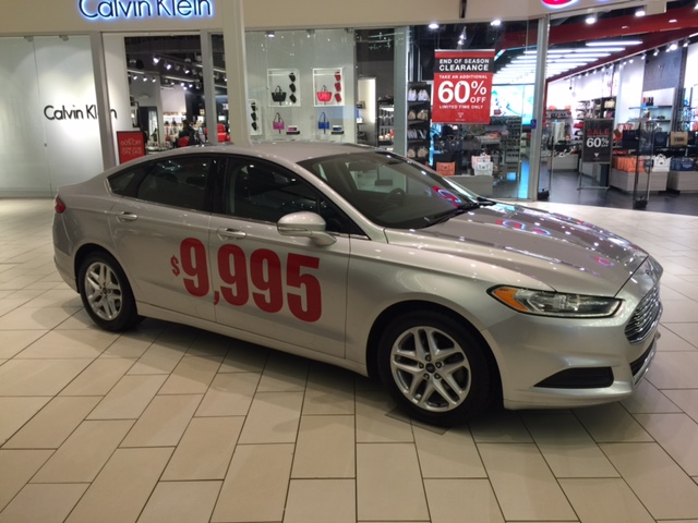

We did magnets for a local dealer a few years back, they still use them to this day.
It was a bear to cut the numbers out but it works great for them.

Magnets only stick to steel. Increasingly, cars are made from alternative materials. It should also be obvious that magnets won't work on glass. (windshields are where most pricing info is displayed)

Our local dealers always display on the sides not the glass. The magnets have worked great for them. Yes as vehicles are made from more alternative materials we have done other things for them, but they use the magnets 90% of the time with no issue.
