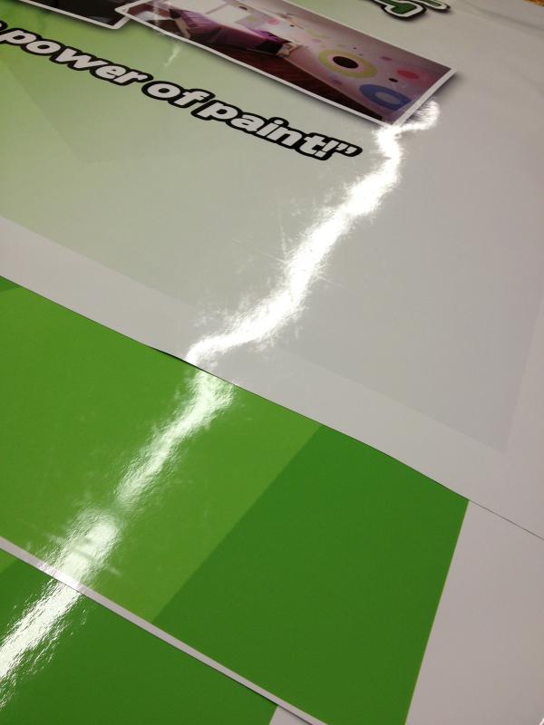

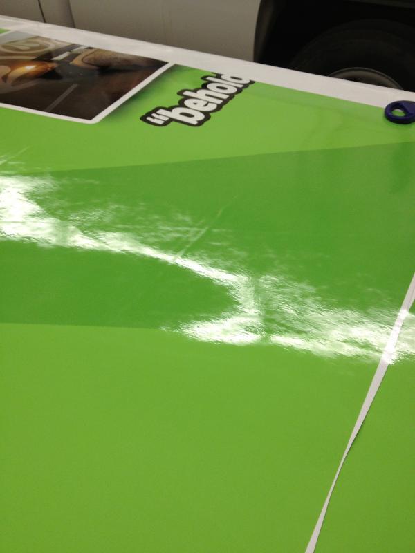

Here are some of the photos from months ago. As I said still to date the blotchiness never disappeared.
As for Fellers, they did replace the vinyl when it happened, but now want me to pay for it, since Avery declined the defect.

I really don't see the problem in your pictures, unless it's the white blotchy areas.

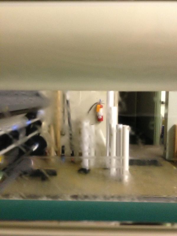

Yes I have a heated laminator, we run it at about 100-110 degrees.
If you look at the photo of the laminator, you will see the cross patterns on the laminate. Those simply do not disappear when applied. So, when the print comes out, and pictures take a little away from reality, which is why I sent part of the roll to Avery, the milky blotches are all over the surface, and look ridiculous.
Actually, during that process, the customer showed up, came back and noticed it right away, and I had to explain what was going on.

looks like heavy mottling, I'd bark back at Fellers and/or try going to a different source in Avery. Did you reach out to Linda there?
