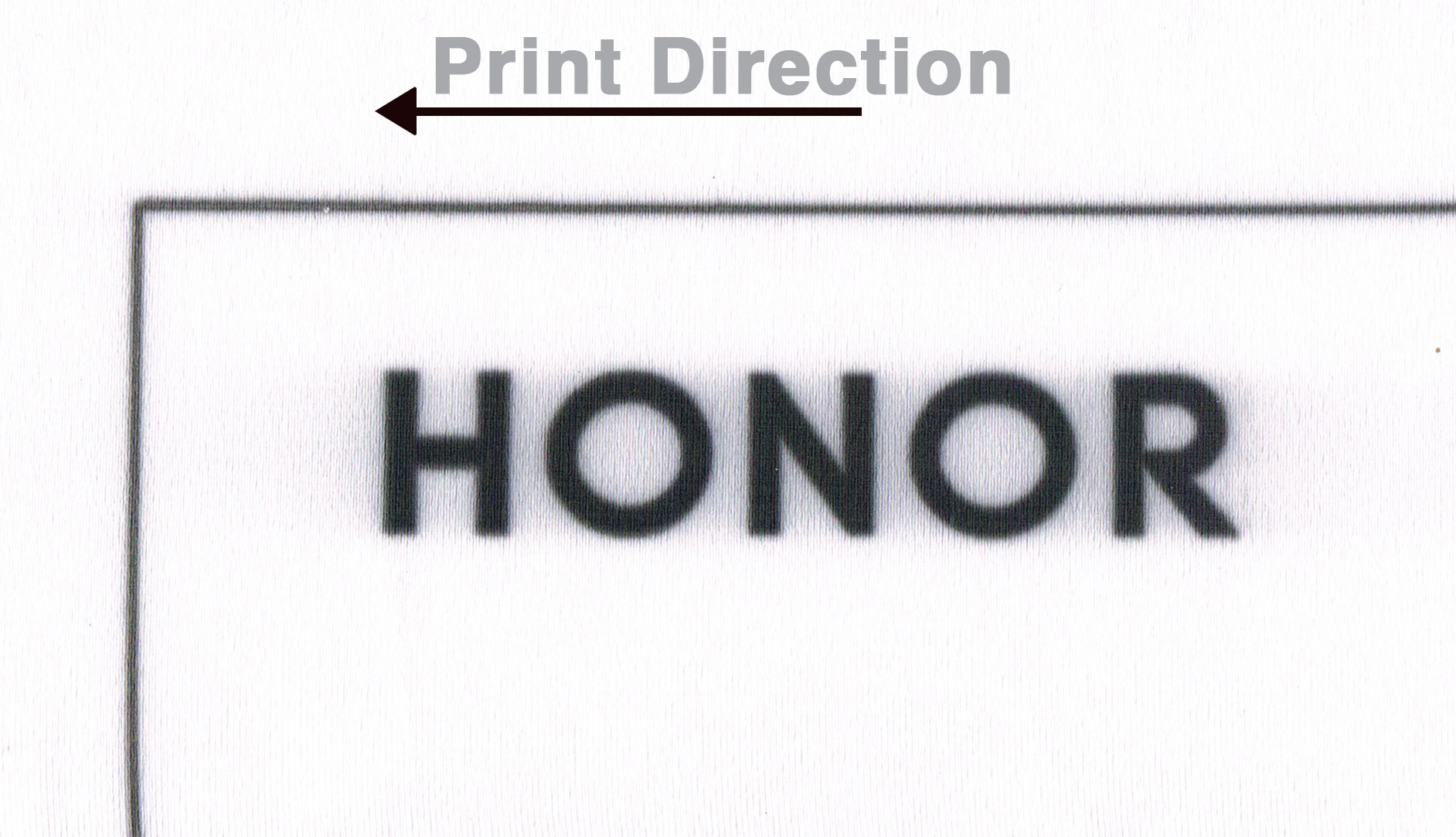

I have bout a direct sublimation printer with an online fixation unit because the transfer method didn't give me color dense for backlit textiles, also it didn't give enough penetration on the other side for flag material.
First day was yesterday, flag material run out smooth and easy with about 75% or more penetration on the back side.
Backlit material had some problems that I need your experience to solve
1- There is allot of ghosting specially around dark areas (picture attached).
2- The colors looks dull, although when illuminated it looks brilliant.
3- I have a massive shrinkage rate in booth length and width of about 7%
Please note that I'm using Sensient Elvajet ink and fixing at 185 degree centigrade at a speed of about 12m per minute
Thank you all again for your time, help and support.
