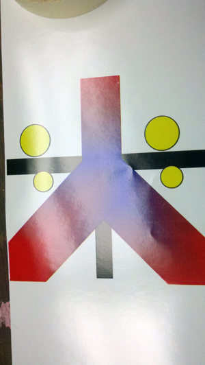

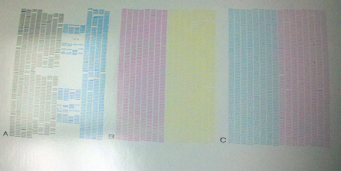

We finally got our system up and running with VW and our SC 540. (took us long enough) The only issue we are having is when I print a gradient there is a decent amount of banding. And also when we did the test print some of the lines we off and missing from what it looks like.

That head
You need to get the black and cyan head cleaned up. That head is pretty bad, get a mirror and have a look at the bottom of it.Shoot me a pm and I'll get you a tech manual
