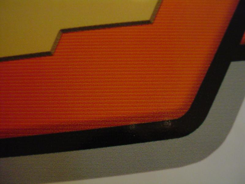

Why would I get banding on only red tones? Everything else comes out great
			Almost always a profile.
Yes, really.
Dot gain banding from too much ink too fast with not enough heat for that color.
You can try raising the heat
Or slowing the printer down (another mode/resolution/more passes)
Nozzle outs/ deflections in Magenta and/or Yellow? Your nozzle test print should tell the tale...
