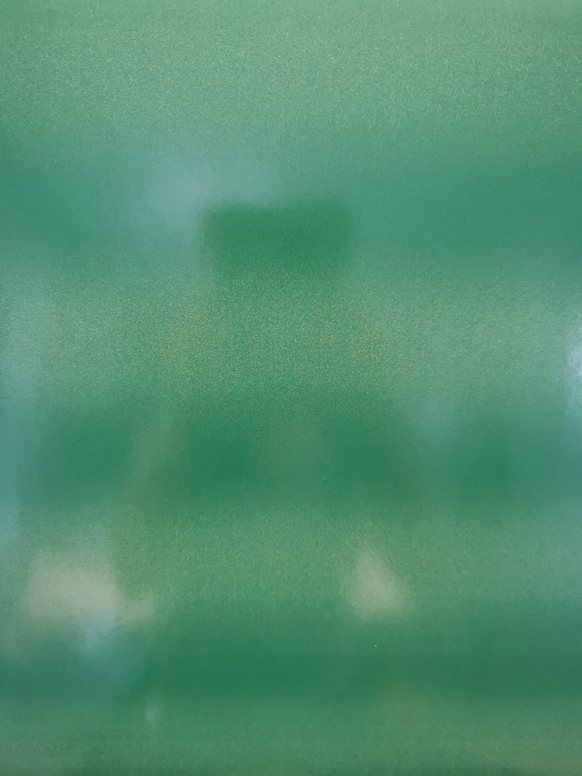

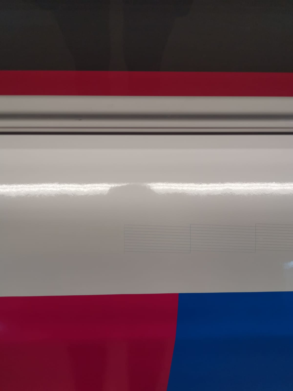

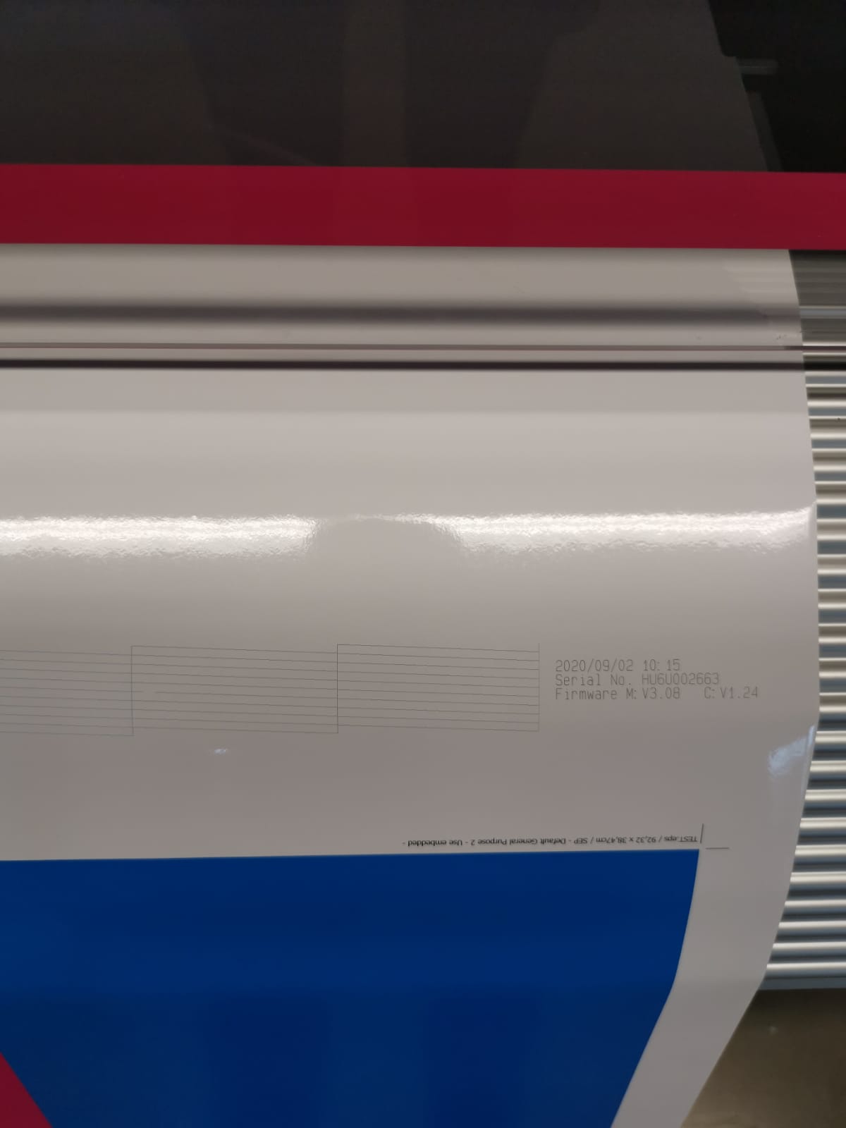

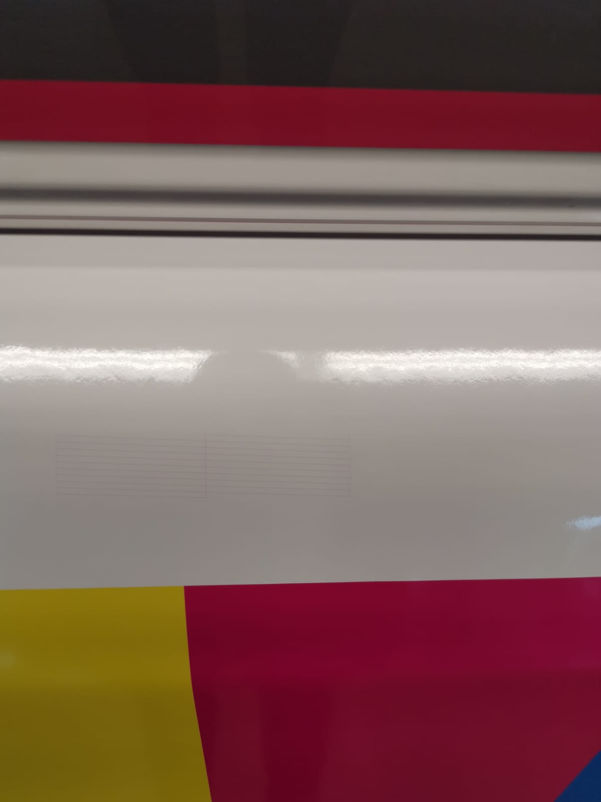

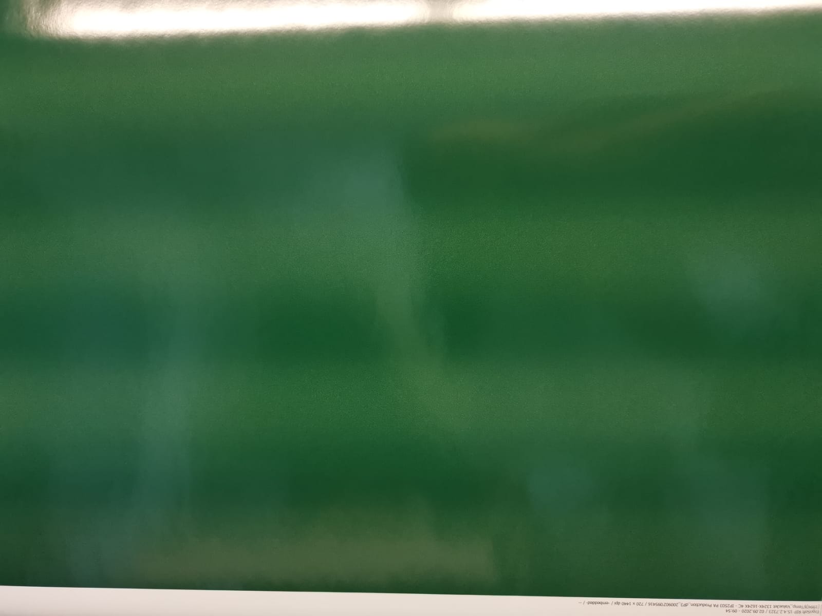

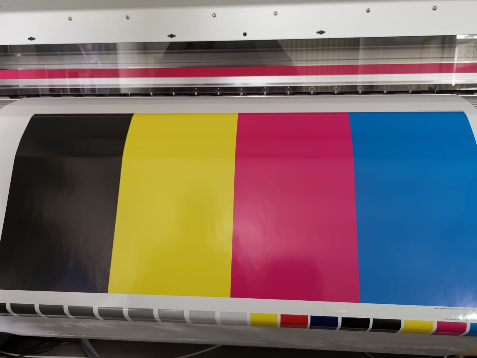

Hello everyone, I've got a problem with our "newly" acquired Mutoh VJ 1624X. The machine has been in our company for a year and we cannot use it because inexplicable banding occurs. Most often in the colors blue, green and gray. We have already tried a lot that have already been discussed here in the forum. We previously had a VJ 1614 and VJ 1604 for years and were very satisfied with these printers. Fast, beautiful colors, fine lines are no problem. So we are not beginners. The new VJ 1624X seems like the devil himself. According to the technician, the machine is in perfect condition. However, the results are still bad.
PF Adjustment: 500mm was readjusted and fits.
Nozzle Check: All nozzles are there.
The vacuum has been set and take up is running.
Preheating was set to 35 degrees and post-heating to 45 degrees.
We work with the latest [HASHTAG]#ErgoSoft[/HASHTAG] PosterPrint Version 15.

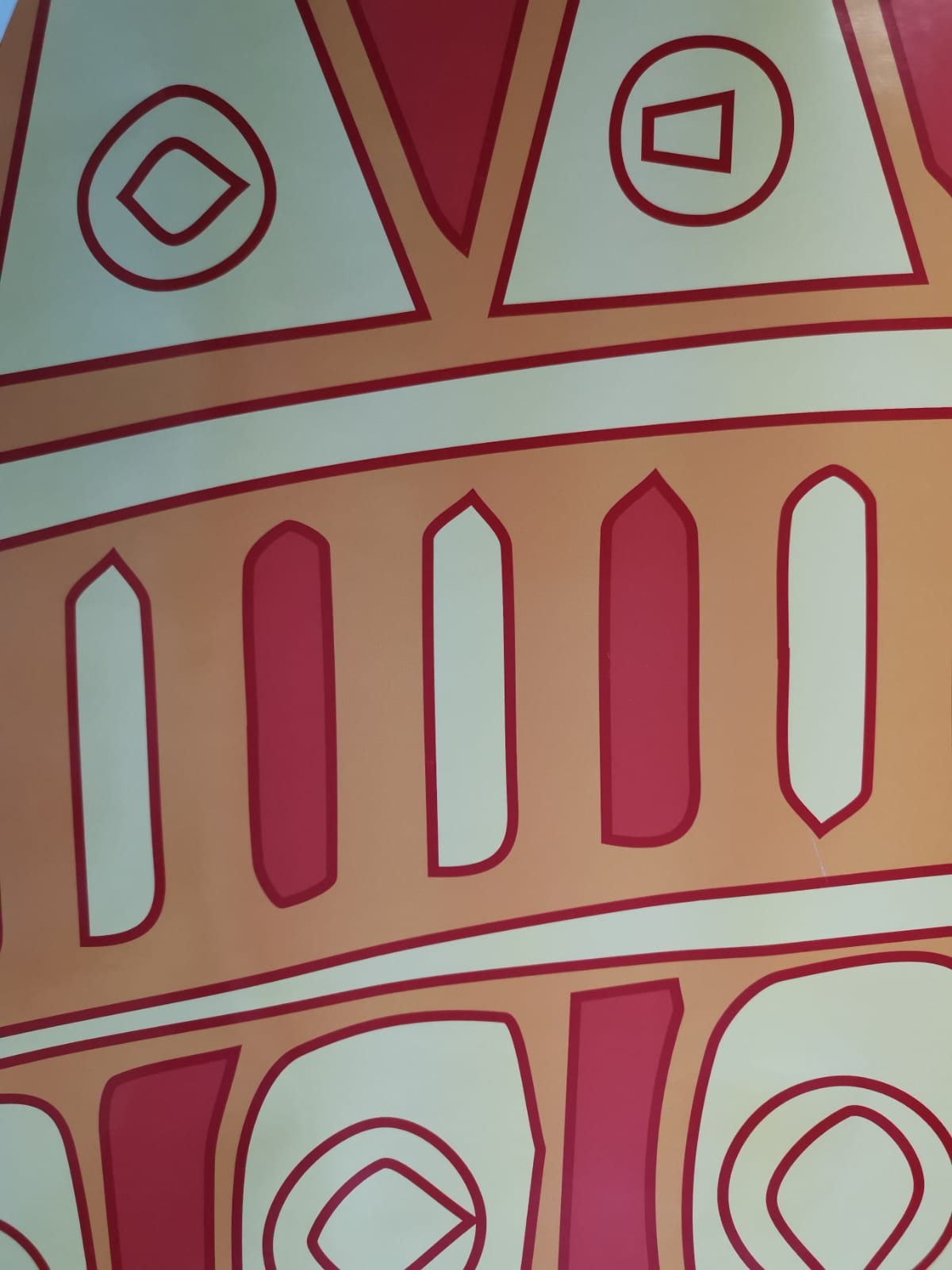

We made test prints from CMYK and they were perfect. There are also no problems whatsoever in jobs with red and yellow. The technician says it's the profile (we couldn't find a suitable one and created one ourselves, including linearization). Otherwise the machine prints well. We are absolutely at a loss. Attached some pictures.
I would love to hear your thoughts on this. Thank you very much. And sorry for my english. :)

It looks like feed problem. Check PF-Motor belt tension, PF enccoder and scale position.
Did you try to release some media from roll on back side? I mean try to print not from roll but from media wthout tension and without take-up system.

It could be a bad damper or air leak in the cyan. You should change the dampers after a year anyway. Has it always printed like this or just recently? If you bought it used, I would change the dampers and cap top and see how that does. It does look similar to a PF issue but the fact that the CMYK print comes out perfect means that can't be the case. The fact that it only happens in blues and greens tells me it's drop out which is when the ink doesn't flow fast enough to the channel to print consistently.

What media are you using? We had a problem profile with our 3M IJ180 that caused banding, though not nearly that visible... I can't imagine a profile making that much of a band?

Cap top replacement helped our last banding problem as well.

Yeah mostly the banding problems are related to dampers, sometimes the temperature when its happening on and off.

My colleagues and I think so too. The ink is running out somewhere else. We bought the machine NEW and had these problems right from the start.
I also suspect a bad damper in cyan. Unfortunately,the technician tell us that the machine is technically working perfectly. How he wants to know without having exchanged the damper, I don't know.

In case with bad damper pure colors on printout should prints bad too.
I think for check it is not feed problem you can create vector file with hairline mesh with cells about 5x5 mm. Print and check the lines.
