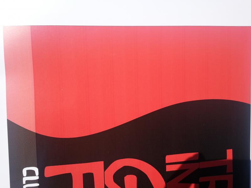

Hello,
We have an Epson SC30600, with a EFI RIP.
1. We have an issue with banding, especially in 720x720 high speed and 720 x 720 production.
This is how the print turns out. I have created length adjustment etc, and still same result. Anyone seen this ?

This appears to be a feed calibration (dark banding) issue. Run the feed calibration adjustment (don't know the specific name for this on the Surecolor) and increase the feed distance for this media.

If you look closely, you will also see uneven color on both the red and the black.
Media adjustment was done, also using the service software from epson, and still the same result. The funny thing is that if you measure 1.5m of print at the end, it is exactly 1.5m. Usually if feed adjustment would be the problem, when doing it manually and checking the distance, this would be different.
We tried with a 3m banner, and it turned out 3m exactly when measured.
Am I getting something totally wrong, or if the feed adjustment would be the issue, the print should have been shorter in this case, or longer when white bands occur ?

I can't tell from the photo, but if the banding is lining up perfectly with your pinch rollers, they are to blame. We had wierd banding with our 30670 after about 6 months of heavy use. Tech came in and replaced them with teflon pinch rollers and problem solved.
I should clarify that I'm talking about the color shifts being in line with the pinch rollers. Best of Luck.

The shift in color is actually perpendicular to the pinch rollers movement, and parralel to the head movement. If I understand correctly what you say, the banding should be in the feed direction, correct ? If this is so, it would probably be paper contamination by the pinchrollers.
It's strange that this phenomenon doesn't occur in 720x1440 production and high quality. Only in 720x720 printing modes.
For example, we are unable to print banners at high speed, as we either get a dark band or a white one. It's getting frustrating.

As it seems we have the same problem. The picture I uploaded was in high speed mode. It depends on what RIP you print, I do it in EFI, and only have 4 printing modes:
720 720 high speed
720 720 production
720 1440 production
720 1440 high quality
IThe photo itself was done as I said in 720 720 high speed. Still this shouldn't occur. Media feed adjustment was done from the machine and still no success.
What happens actually also when I print 720 720 production, I get banding! , more like a gradient banding.
If you can do this, please printa sample 20 cm long full colou, maybe search for cmyk picture on google, and take picture and post it. From what someone at Epson is telling me, it should still come out clean, even in high speed mode. Altough if you read the customer expectation manual it is a bit different. The manual claims that banding is expected to appear in every printing mode except high quality. r
