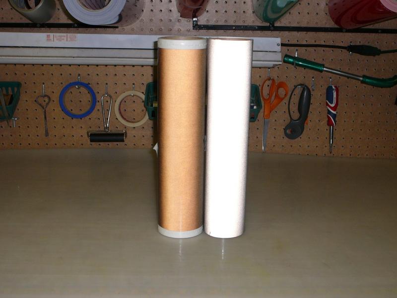

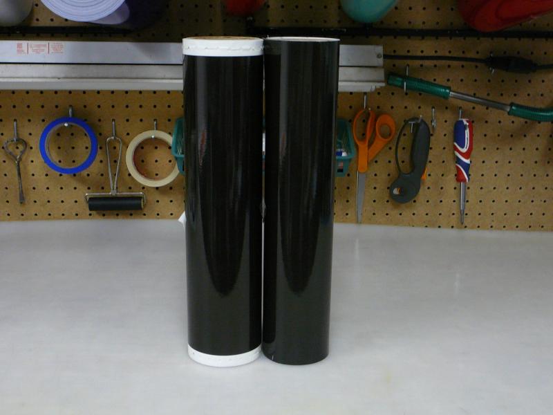

White reflective for instance, is only white when it’s doing its thing. In normal daylight settings, it tends to look slightly grayish or pearlescent At the other end of the spectrum, black reflective has to look different when light hits it because black is the absence of light. So black reflective looks brownish when it reflects light after dark.
