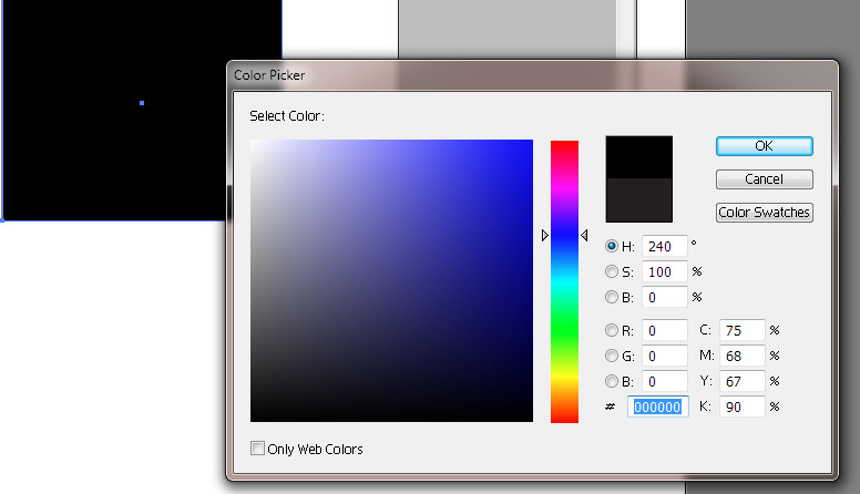

Whats everybody using for a good black, my blacks are not coming out the best on my VP-300 with Coreldraw?

If you use Illustrator or CorelDraw X5 use RGB black (0,0,0) and switch it to cymk, it will give you a very nice black (75,68,67,90).
Once saved to the pallet you don't have to remember it any more.

Going to depend printer, media and ink. You may find that 20C, 100K will work, you may need 40C 20M 20Y 100K. In general I like the Cyan higher than M and Y , but prefer just Cyan if thats all thats needed.
