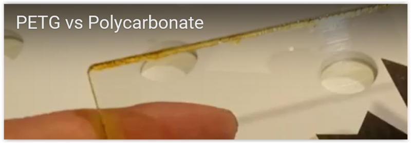

I searched google, youtube, and this site and could only find one video that shows the yellow stain left on polycarbonate after it is laser cut.
here is a screen grab from that video:
my question is what is the best way to remove this yellow stain?
I will be using white polycarbonate and don't want it to look that ugly. it is my first time using it and I was warned by my laser cutting company that this yellowish tinge would be present.
