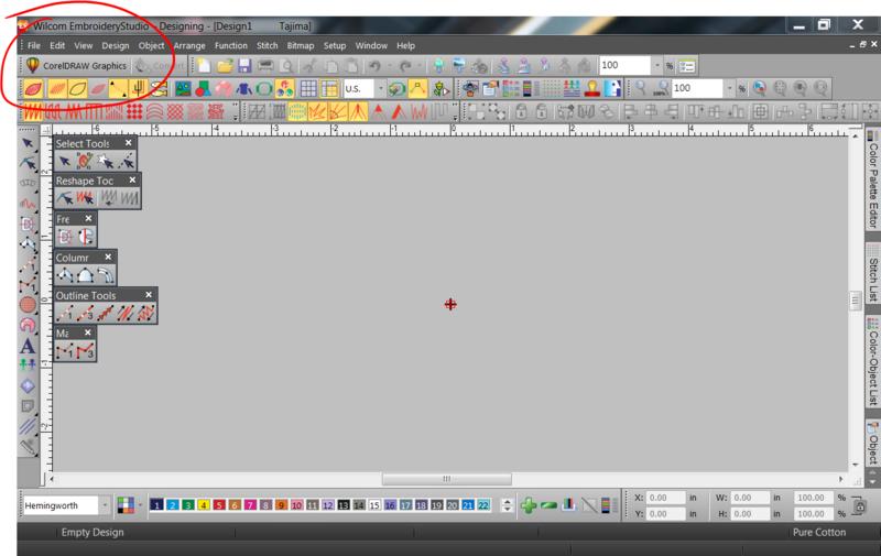

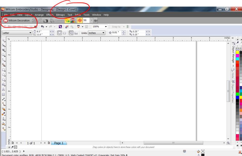

WildWestDesigns
Evan this is a totally fresh install on new SSD drives so should not have that issue. Thanks for the help.
That should be no worries at all then.
3. as for those programs you mentioned.....dont much matter as they will load independently of the others.
Not with regard to Wilcom. Wilcom runs CorelDRAW from within the program. It needs to have a separately installed version of DRAW x6, but it is still run within Wilcom itself when you use the Wilcom-Corel Interaction Button (their title, not mine). If you install Corel before Wilcom, you run a high chance of Wilcom not reading Corel correctly every time.
